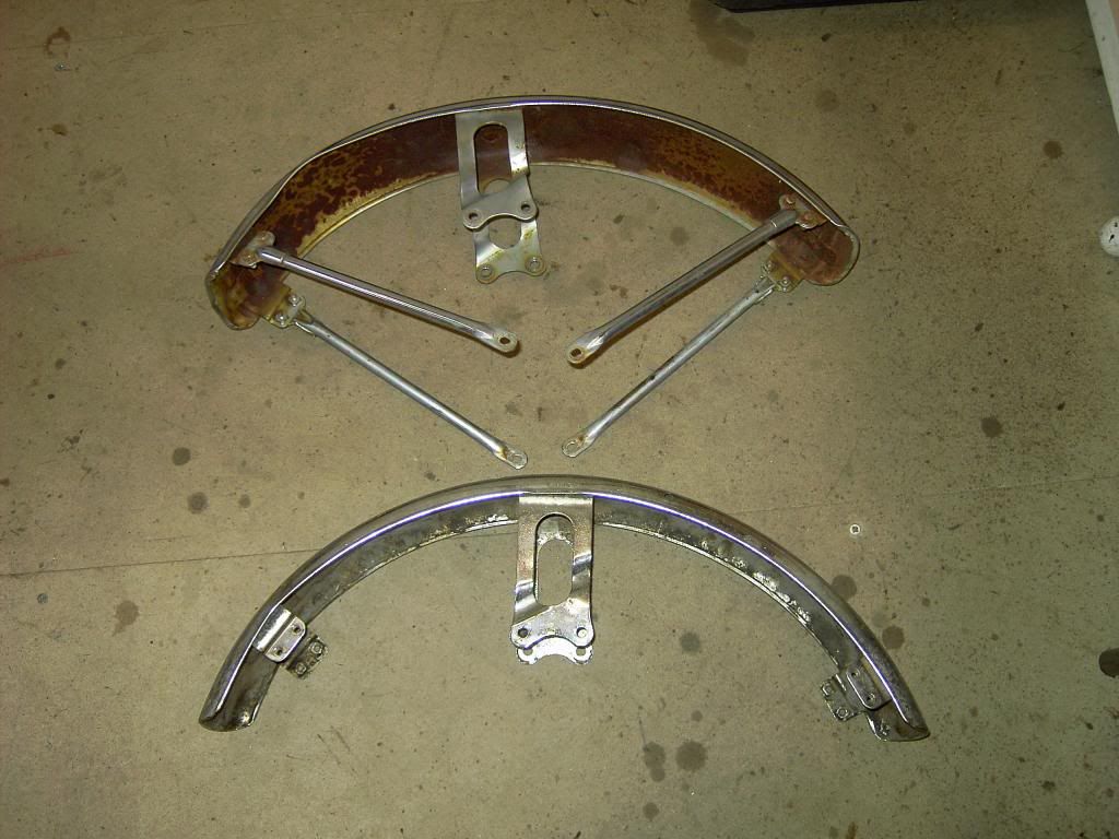

I've got two front mudguards, both need repair/rechrome.  One looks like yours and the other had a front number plate on it and the front part of the mudguard overhangs the stays more than the rear if that makes sense - hence my position of not knowing what's correct half the time  :D
For instance, these are my two mudguards, the bottom one had a front number plate attached:

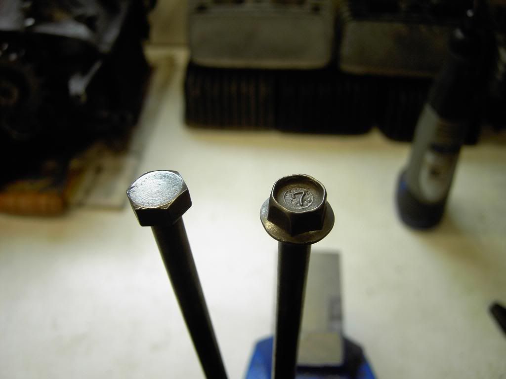

I've got two sets of engine bolts - which ones are correct?

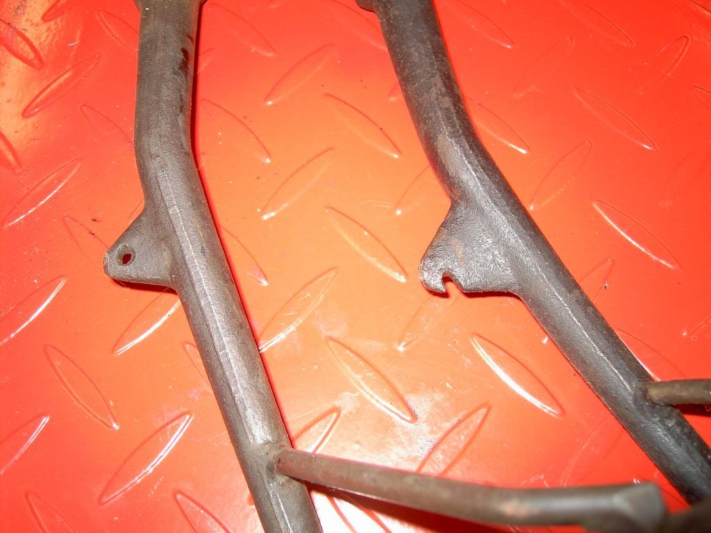

Two different side stands for locating spring:

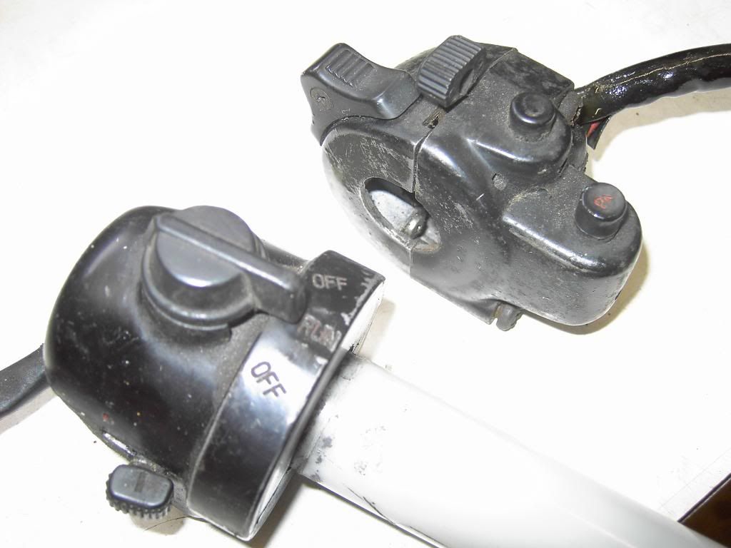

Switches - correct?  ??? (P.S. I've got sausage fingers so does anyone refurb these on the forum  :D)

My original unrestored late '72 built RD350 US spec has: the shorter front muddy with rounded head bolts in the stays, the non-flange engine bolts without numbers, the sidestand with the hole and all black painted carbs.   If you paint the carbs, you will need to use a heatproof paint like PJ1 or Plasticote BBQ black paint and, cure it carefully in the oven or, it will peel off.  ;) ???

The one with the number plate holes is a UK one.
I have one of them on mine now.

Switches are correct, mine has black carbs (UK model).
