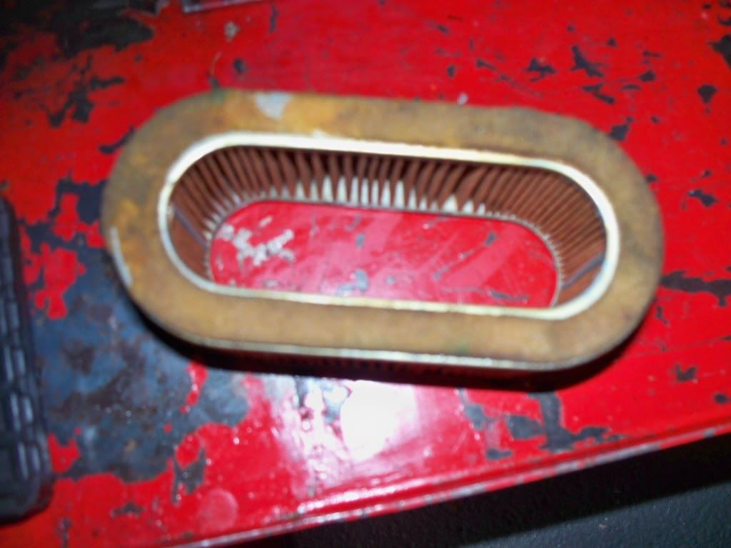

First was to remove the fuel take and drain the gearbox oil, with this done I thought it best to change the air filter to save doing it later.
So out with the old.
And in with the new.
I was surprised how rough the old one was for 2000 miles.

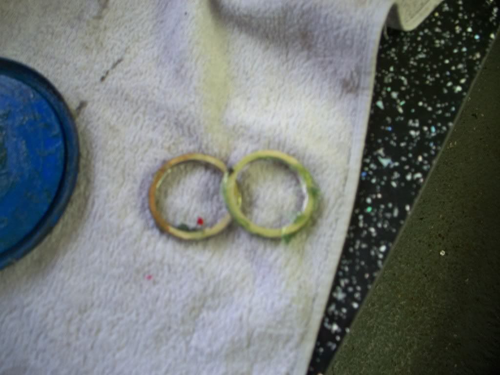

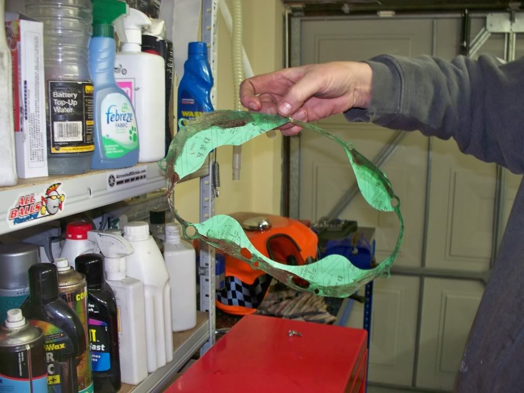

Then I thought I would remove the knackered battery, this is only 2 years old but has always been a problem so a new one was ordered.

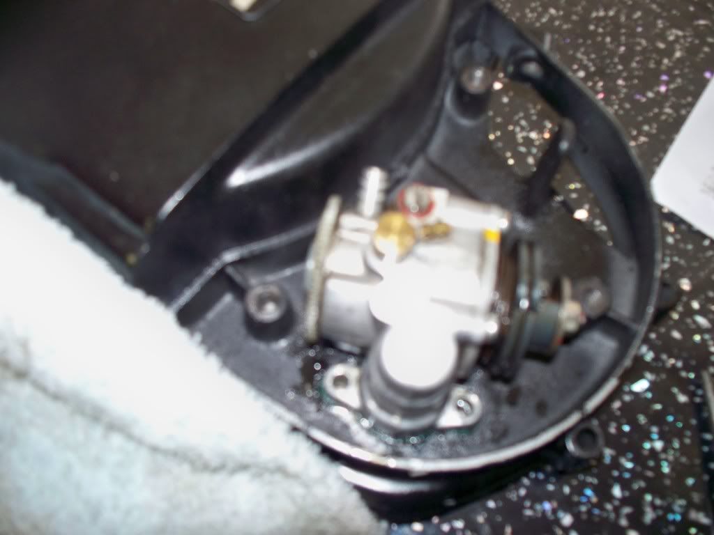

I removed the battery box just to check to see if there are any electrical problens and I found this.
I am wondering if this is the cause of our battery problems.

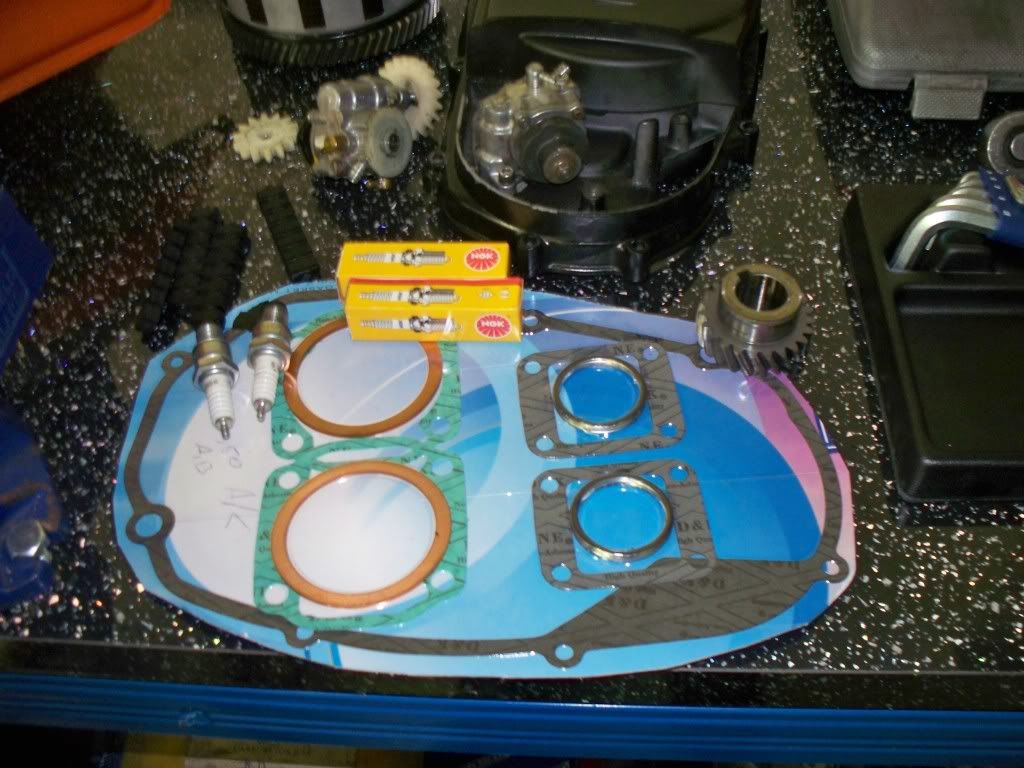

So after talking to RDnuts about this back in the summer and various discussions on the forum we figured out what we needed.
Heads
Barrels
Piston kits
Oil pump
Primary drive
Clutch basket
Rev counter drive

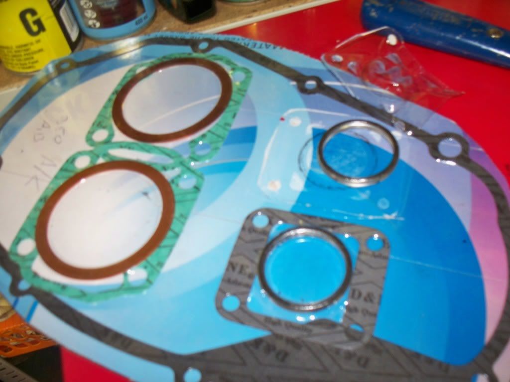

Gasket kit
Oil
Spark plugs

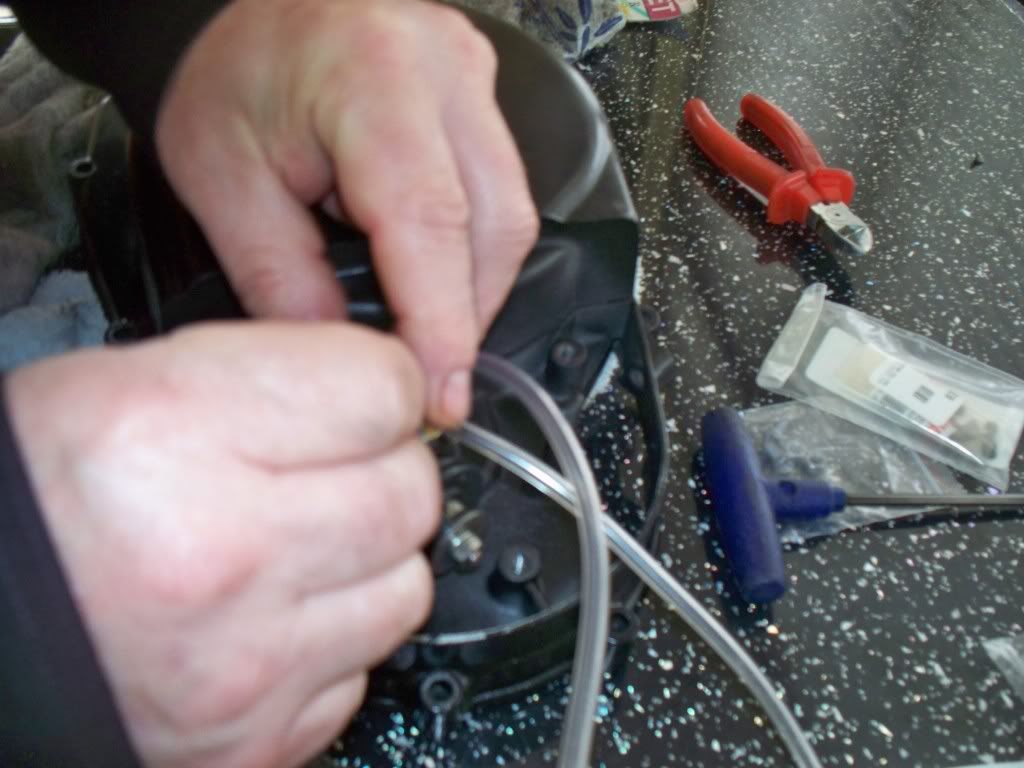

While we are doing the conversion I thought I would also change the oil lines for clear pipe and service the bike.
I have already removed the tank, drained the oil, removeed the kick start and removed the side casing.

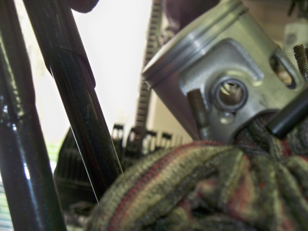

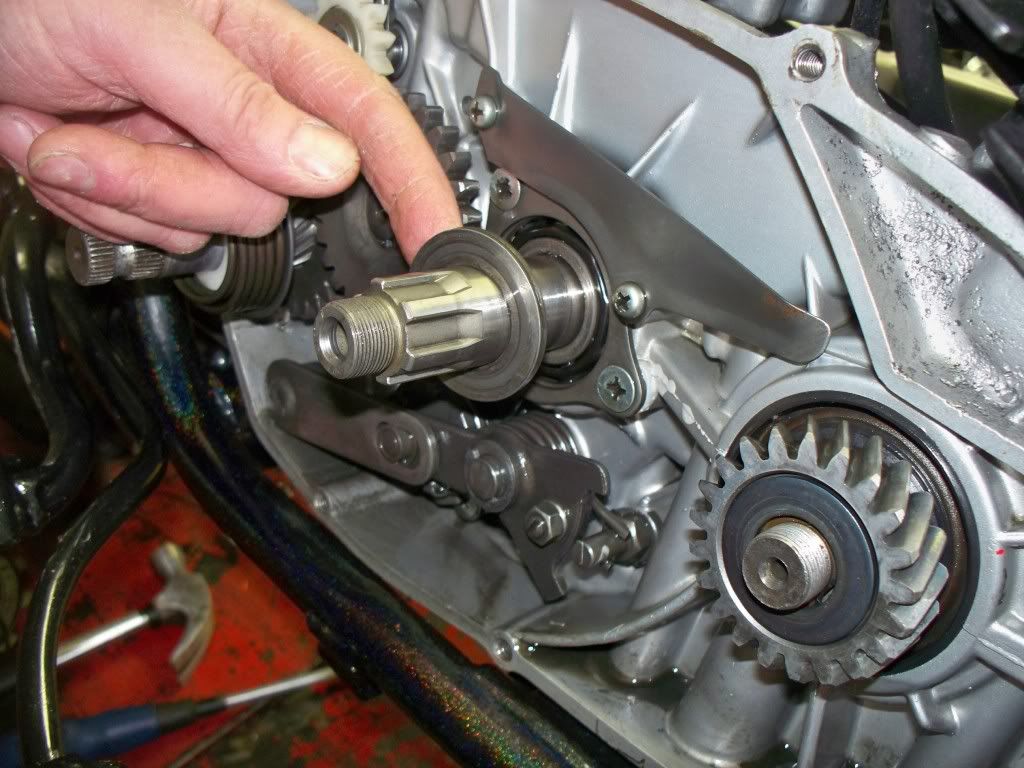

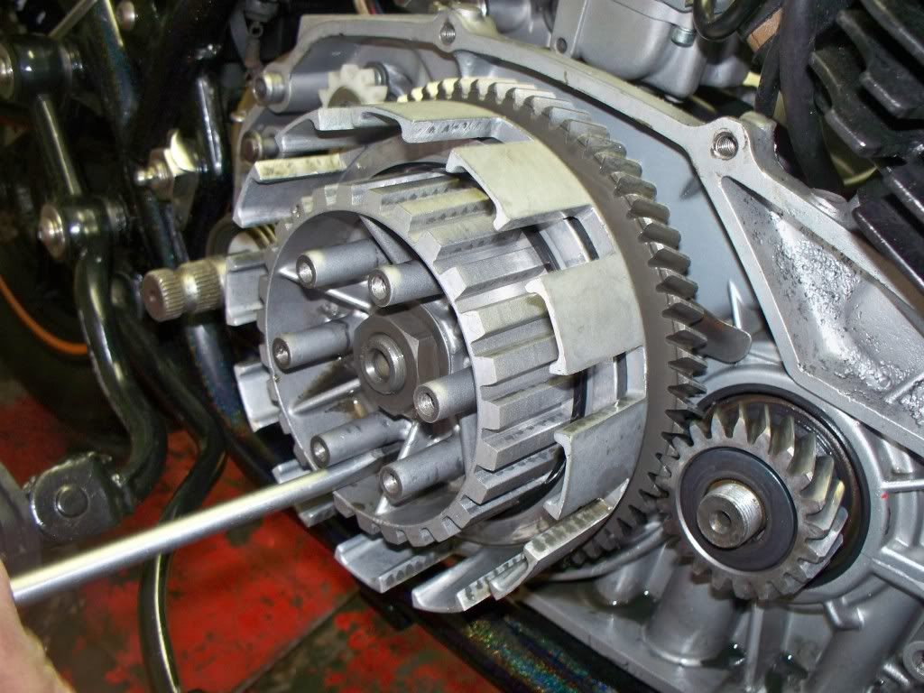

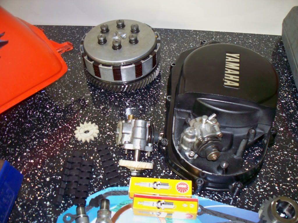

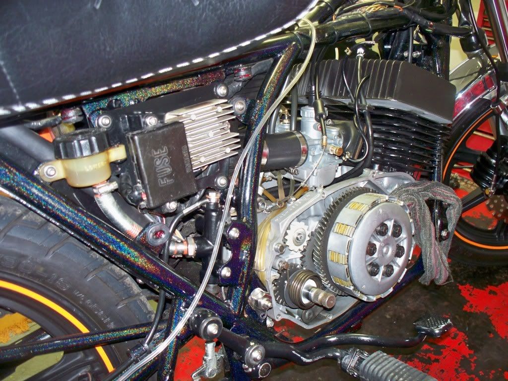

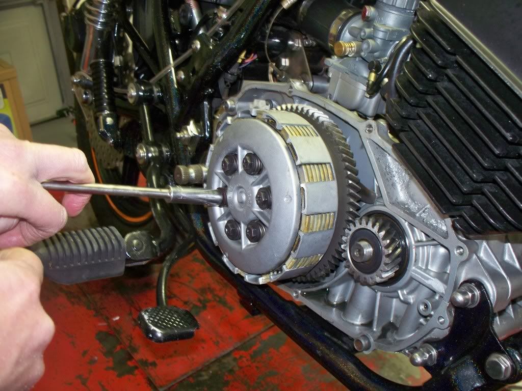

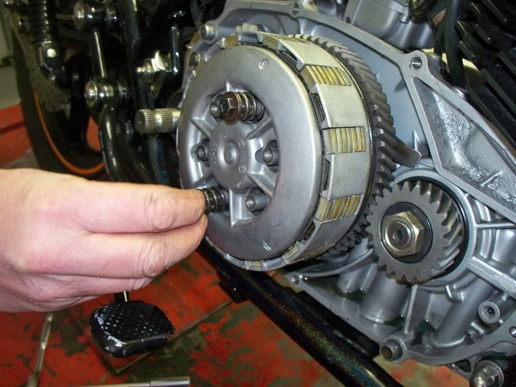

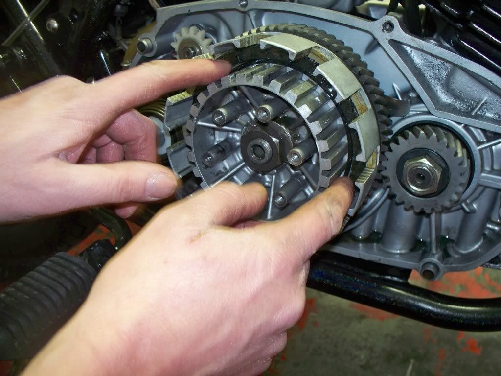

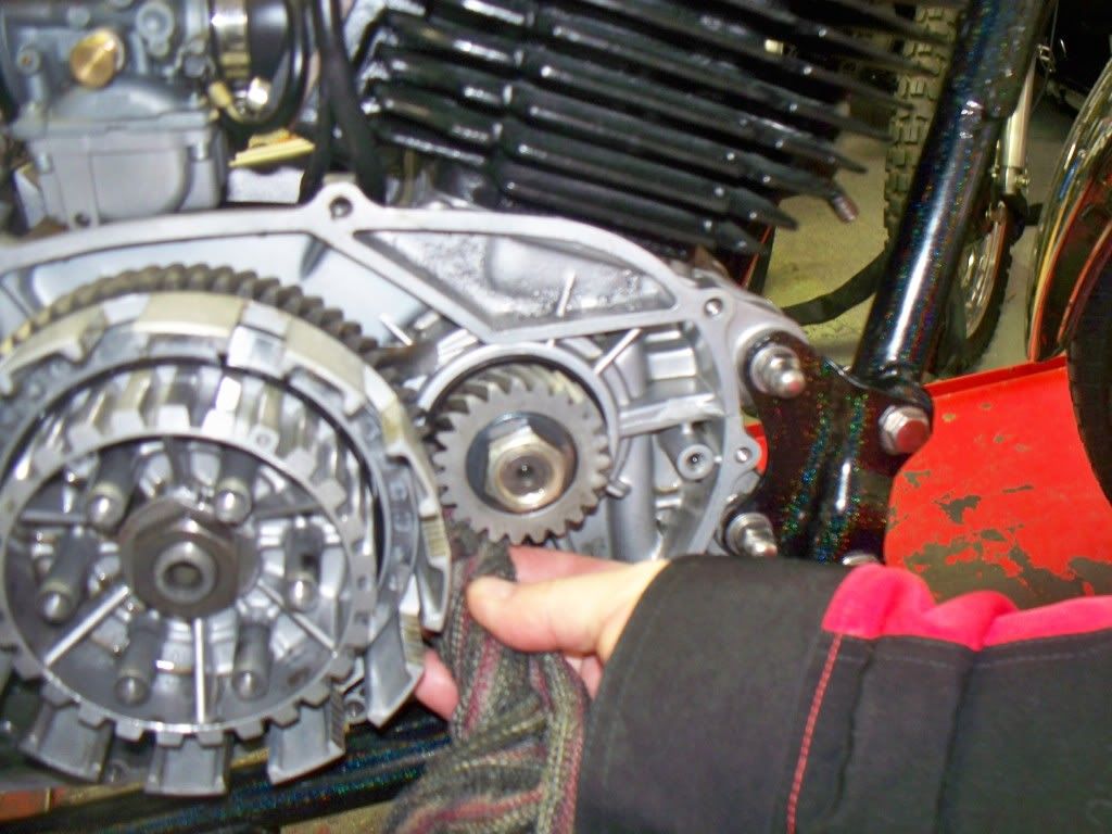

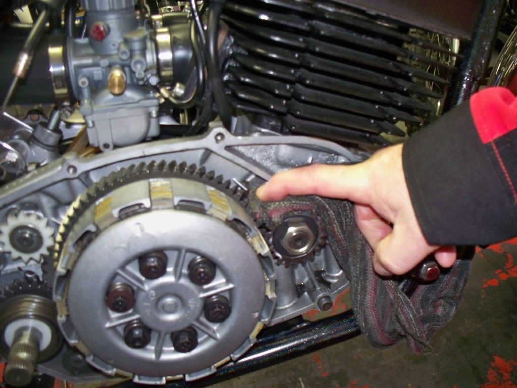

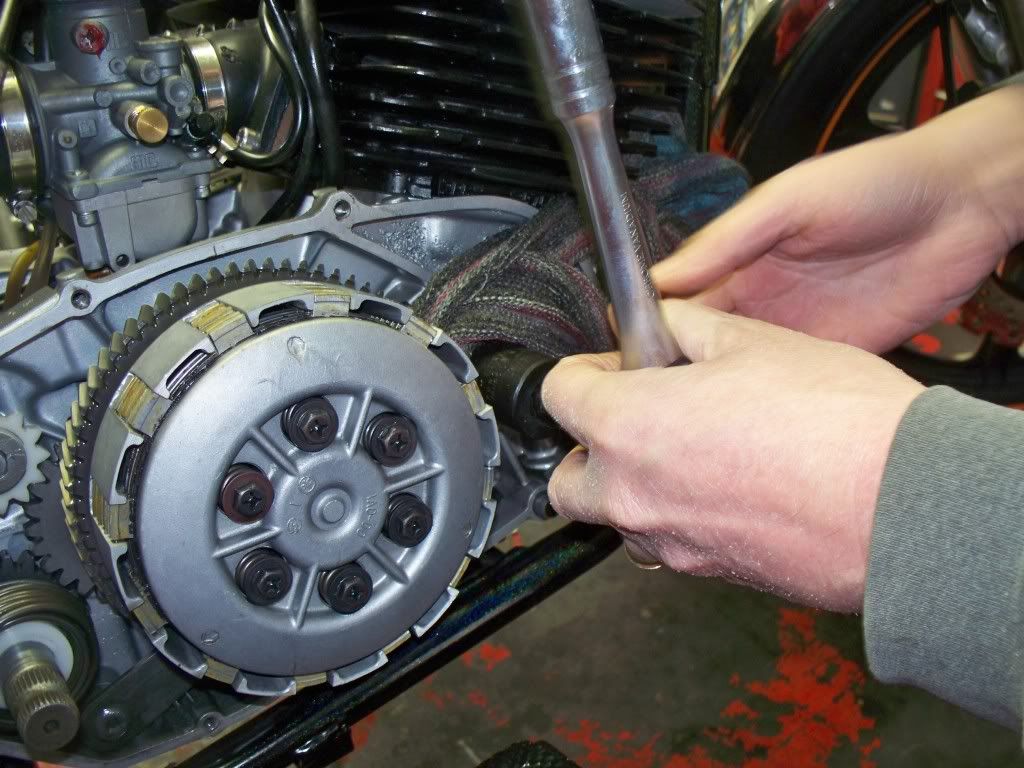

So we need to undo the primary drive and cluch basket, this is dave little trick, stuff a cluth in the cogs to hold it tight.
Now ready to undo the primary drive

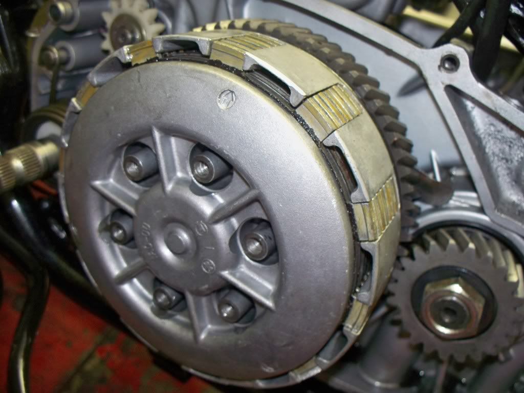

Then the clutch

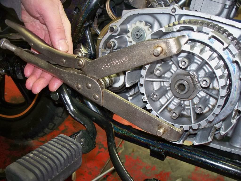

Daves clutch holding tool (I must get one of these)

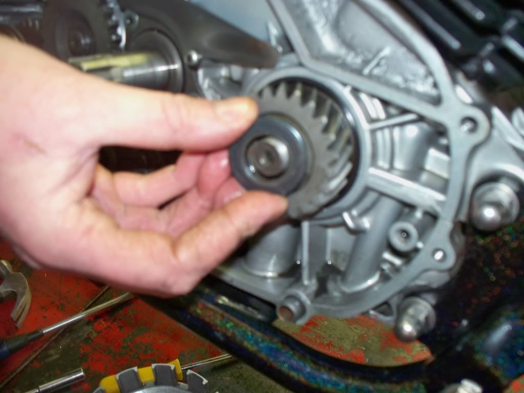

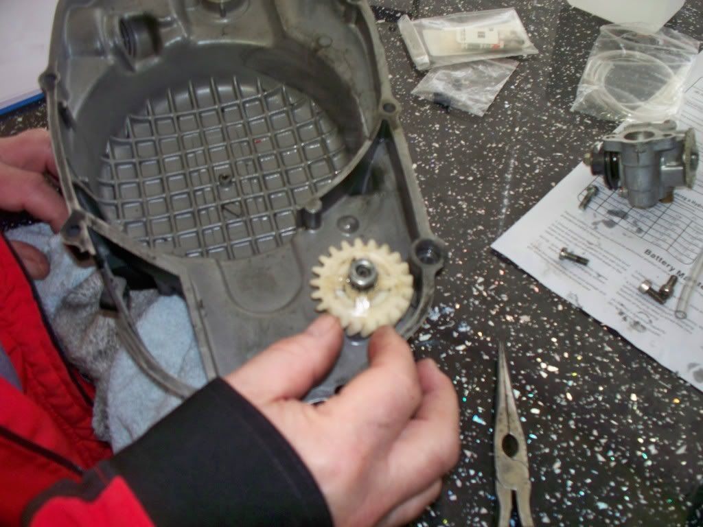

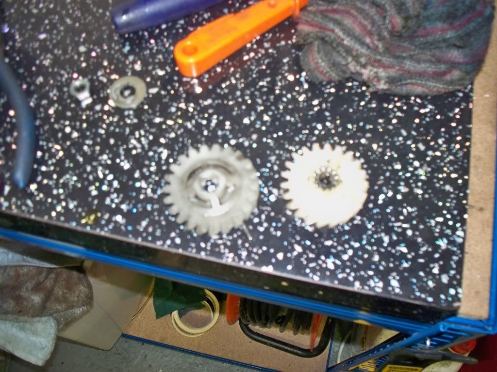

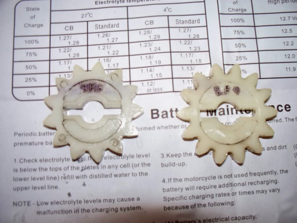

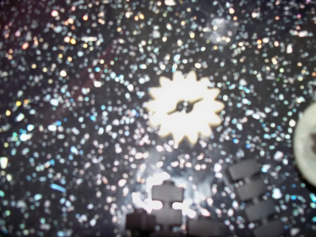

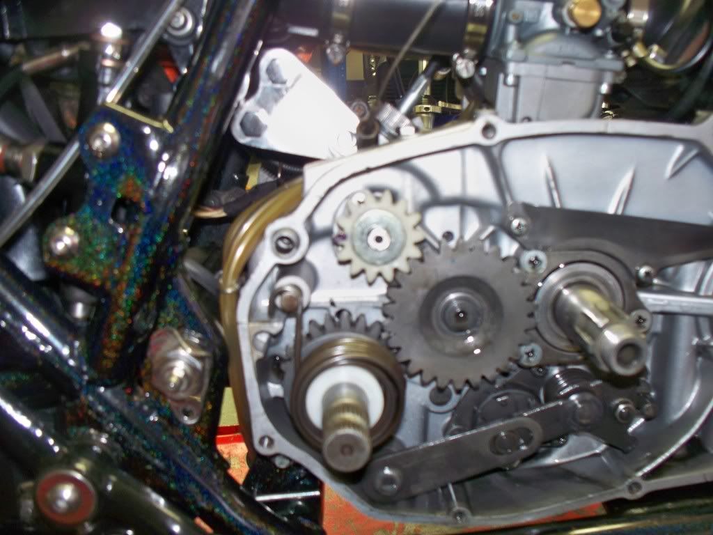

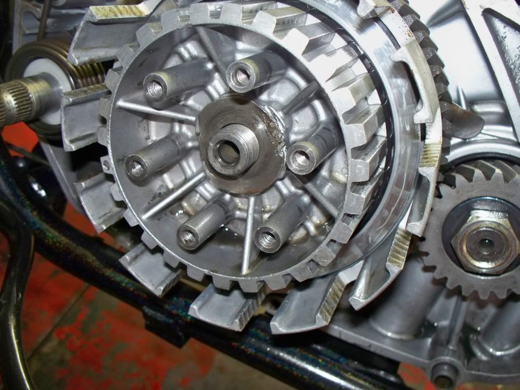

Primary drive and cluch basket removed now time to change the tacho drive wheel for a 2r9 (400E version)
This has one extra tooth and  different profile tooth but it fits straight on.
Note the different pre-fix numbers 2R8 for the old one and 2R9 for the new one (Donated by moist)
Now fit the 350A/B primary drive.

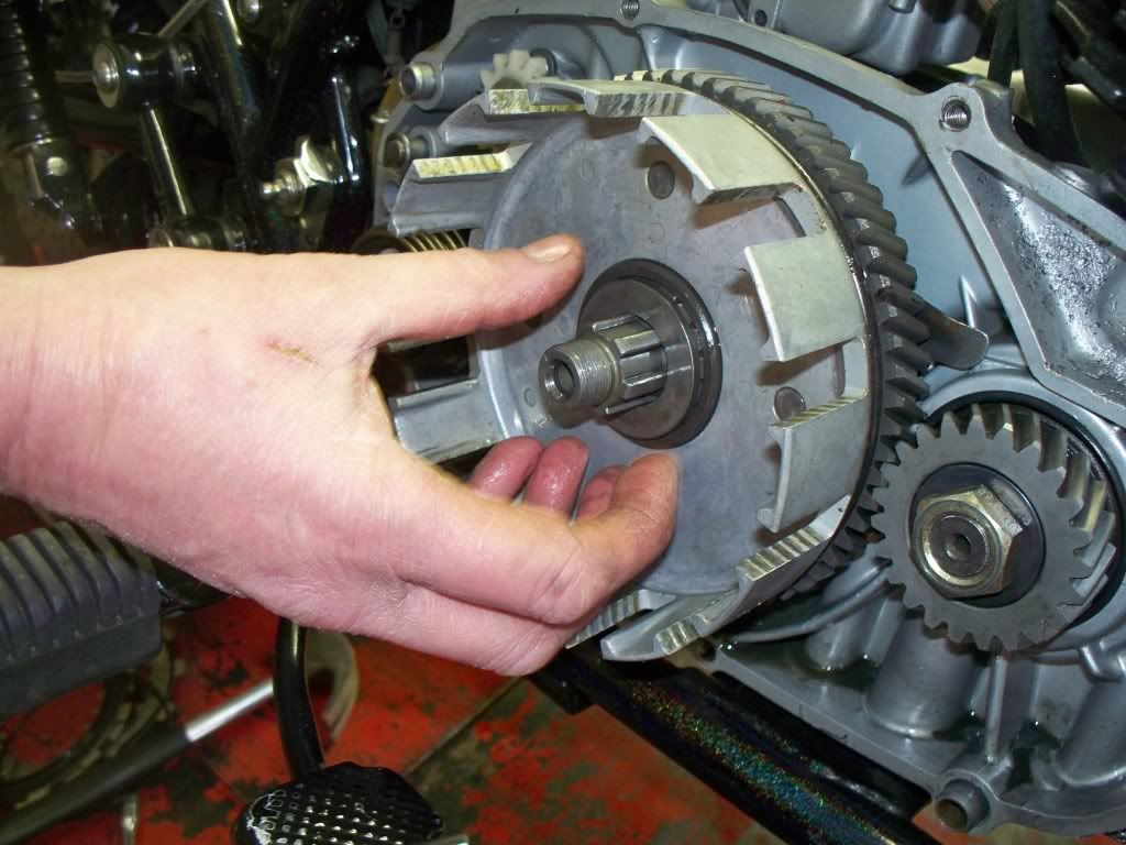

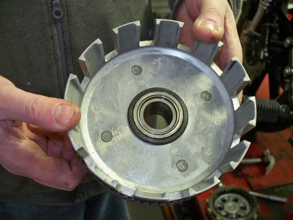

Then the clutch basket

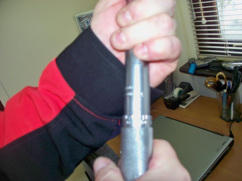

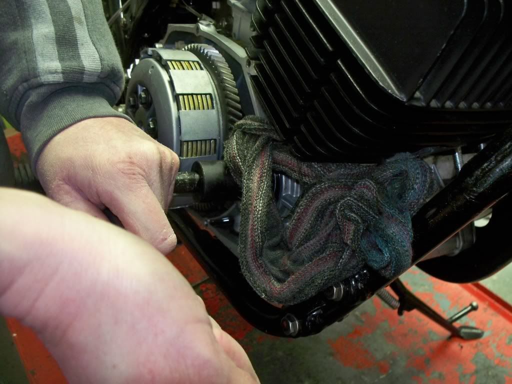

Set the torque wrench to 56 FT LBS
Jam the cloth in the bottom this time then torque up the cluch and the primary drive.

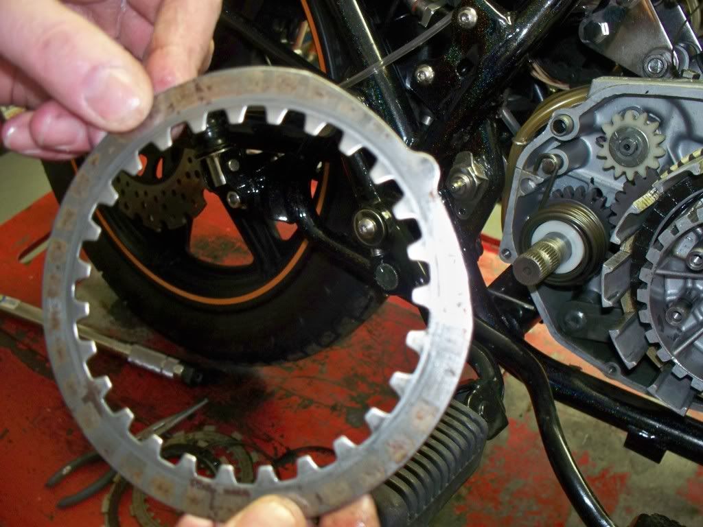

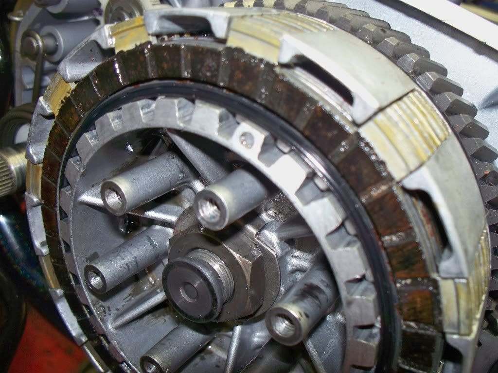

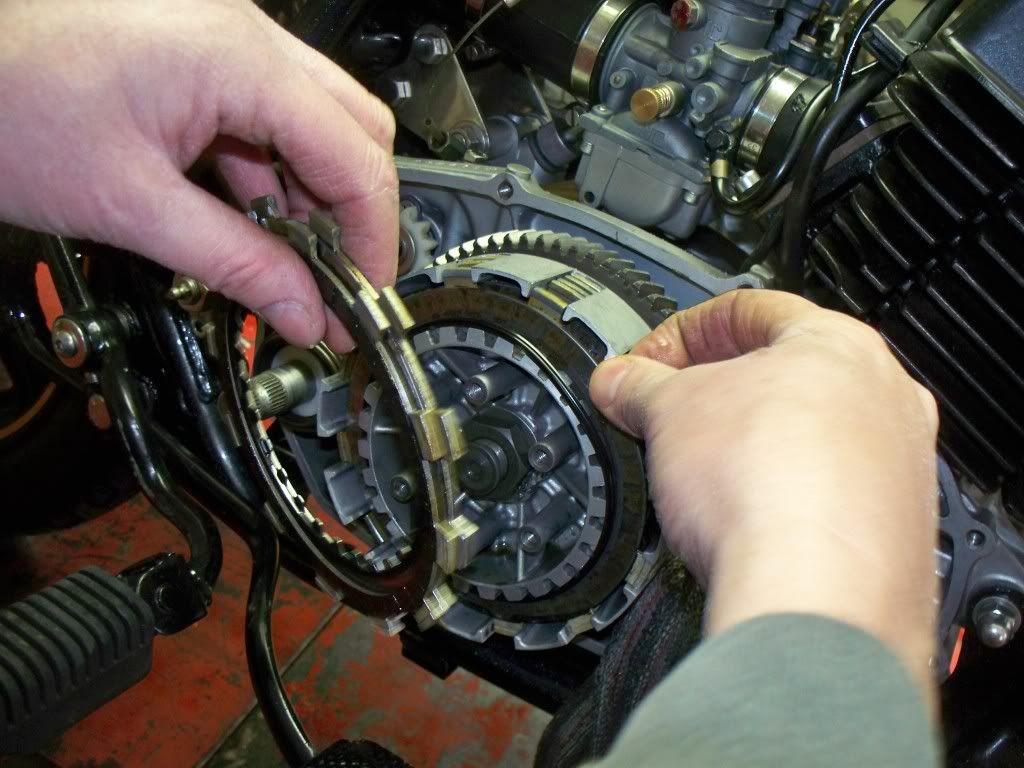

Re-fit the clutch plates in order.
Fit the coller and springs

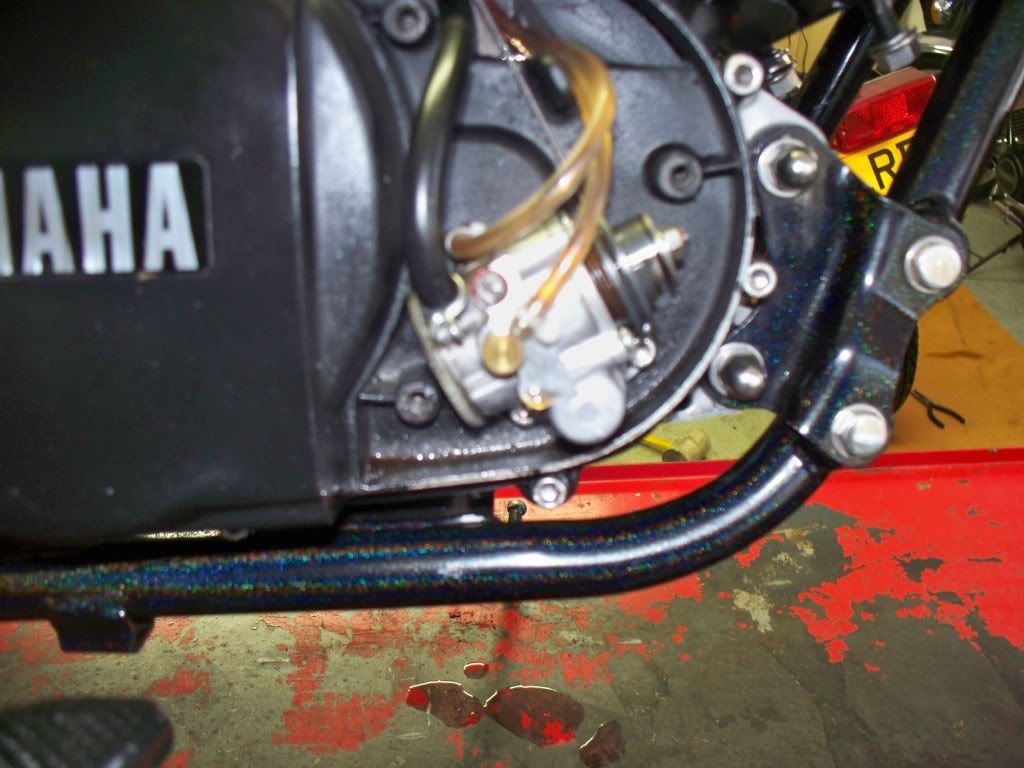

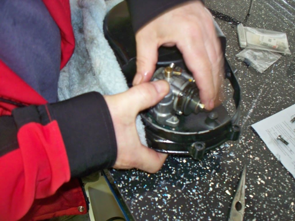

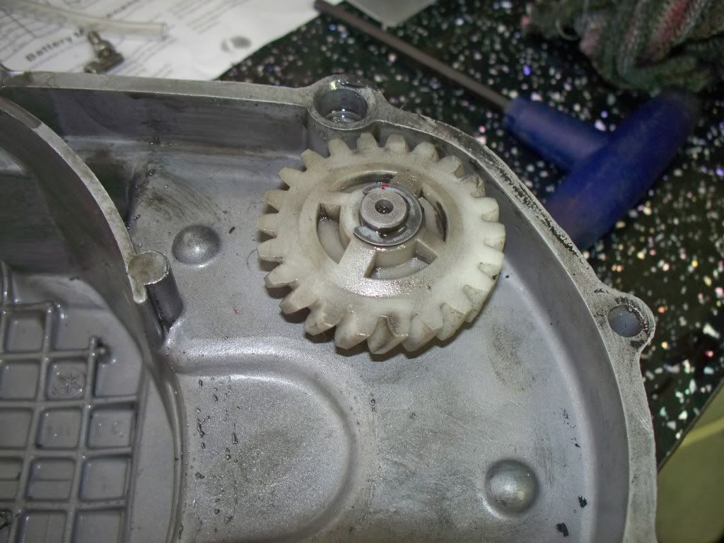

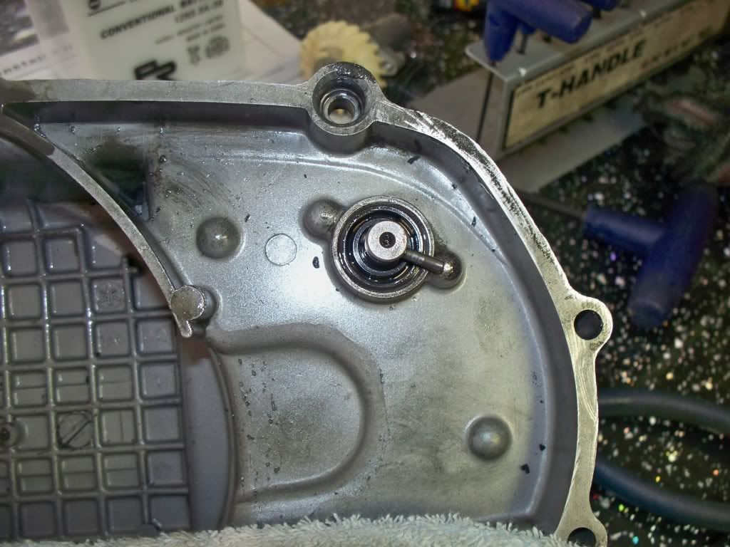

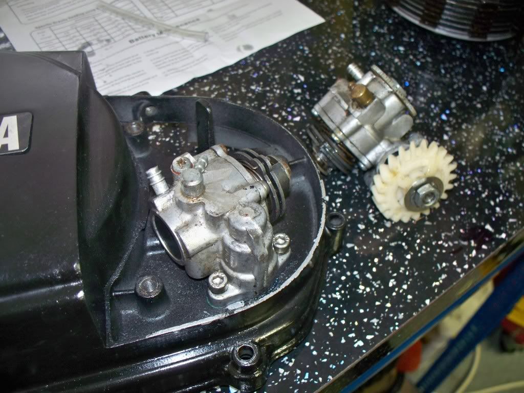

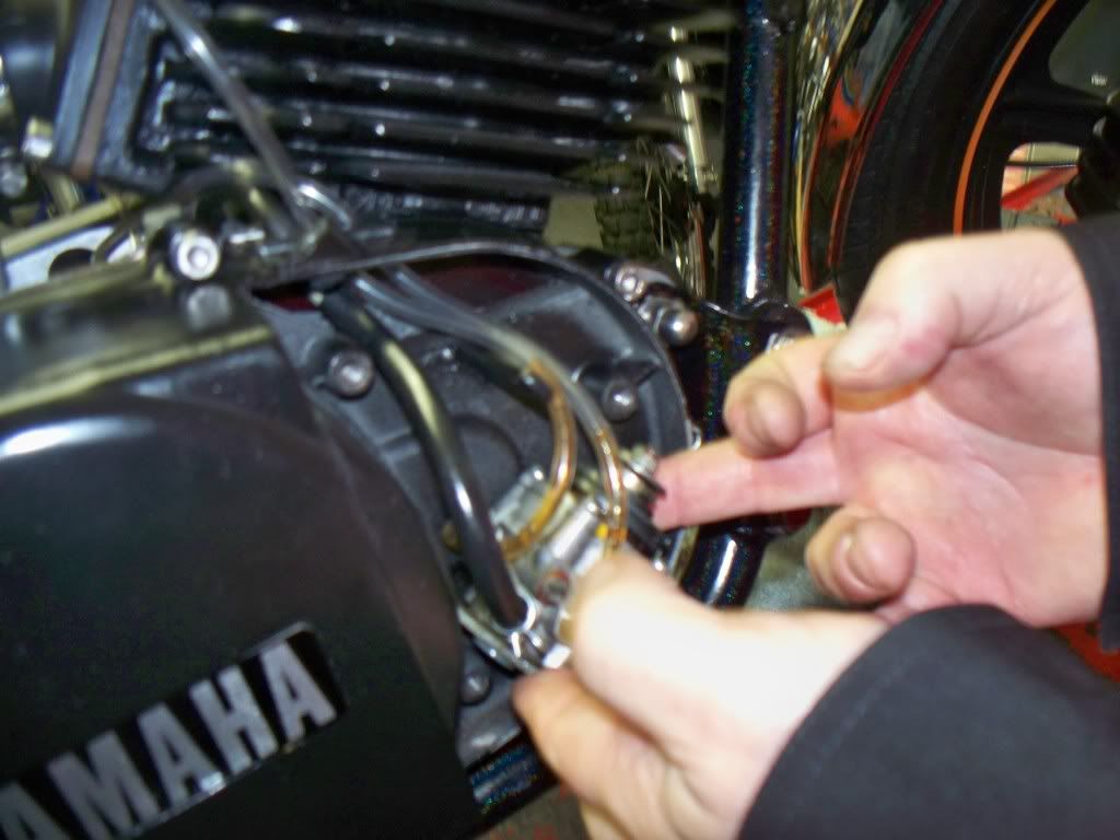

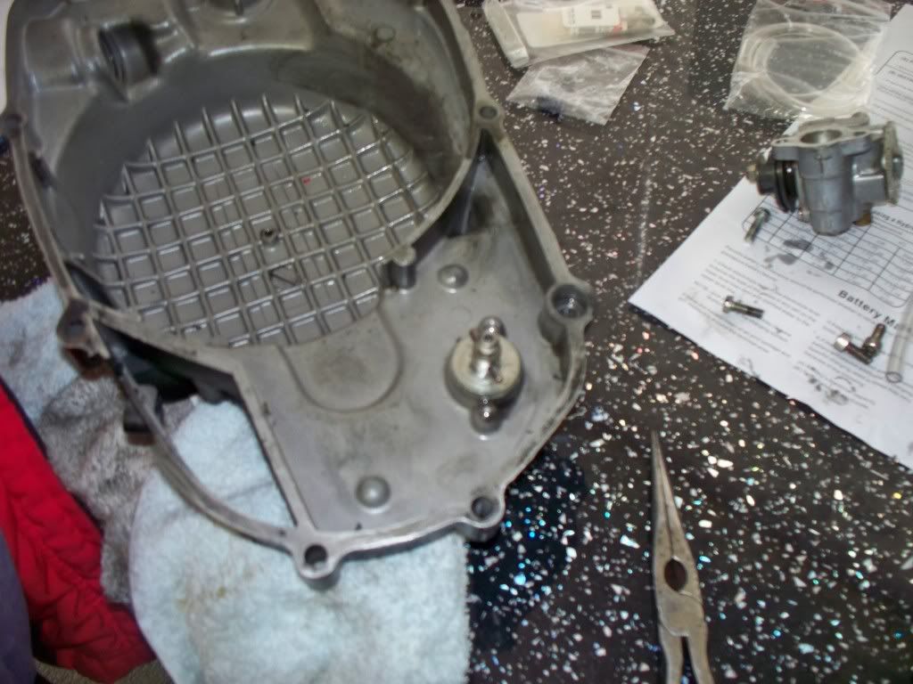

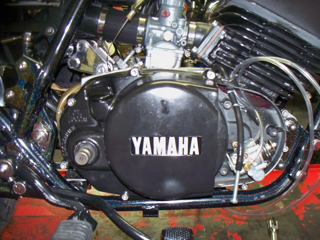

Now swap the oil pumps over
We may as well do the plumbing while the case is off.

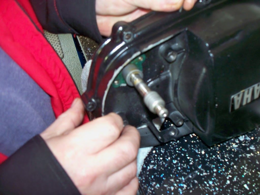

Smear a drop of grease over the gasket to hold it in place.

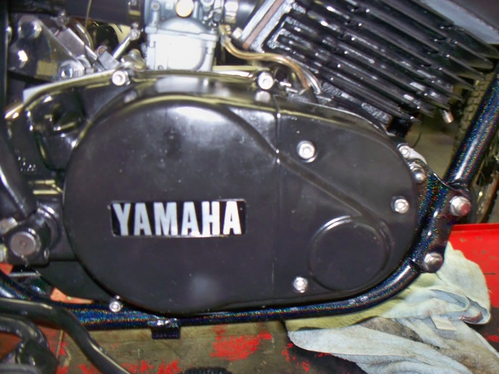

Refit the case.
Refit the kickstart

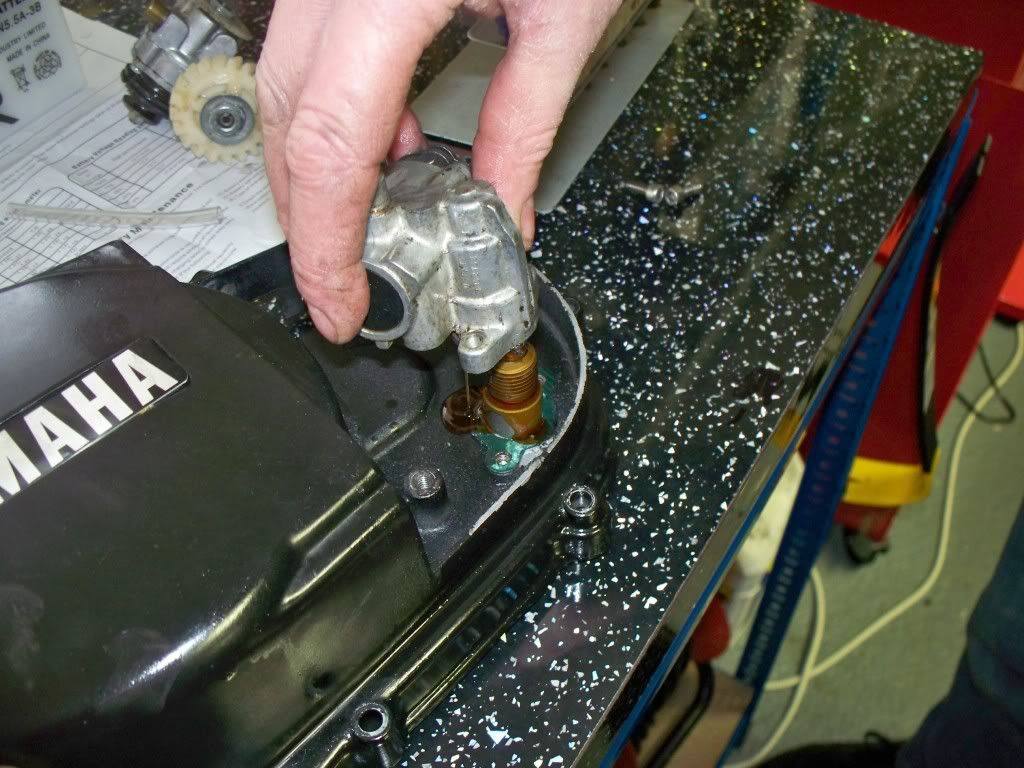

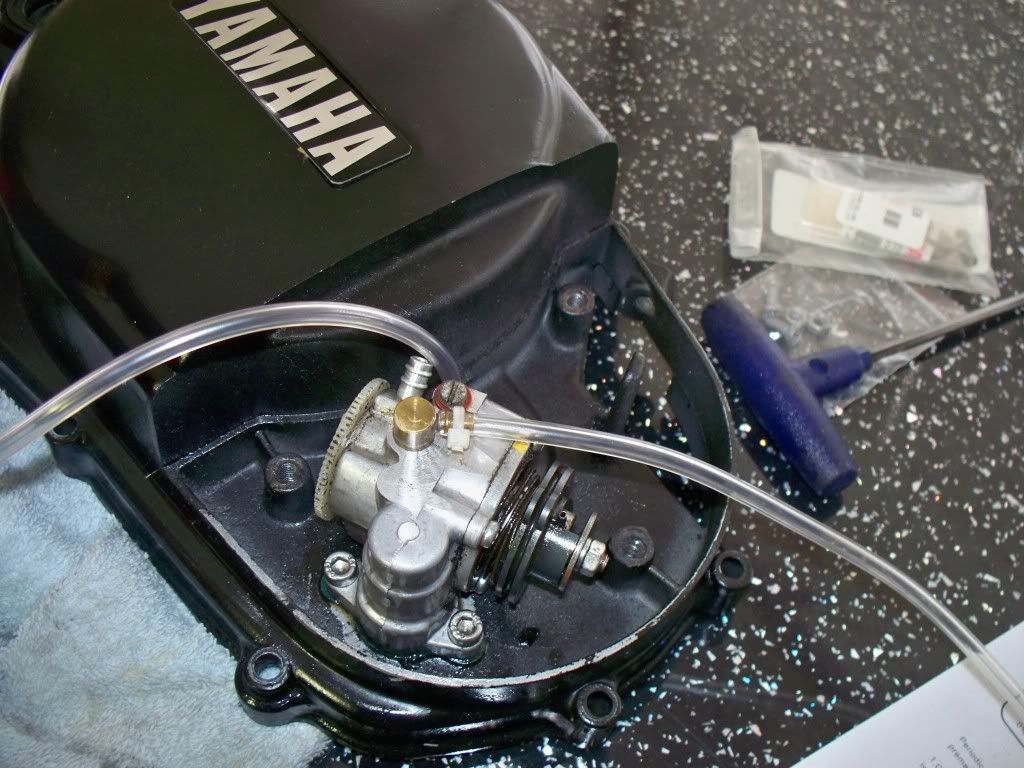

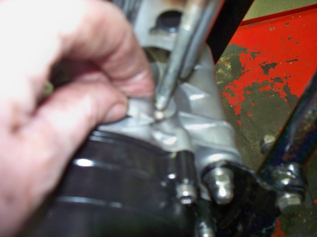

Prime the oil pump This is much easier on the A/B pump with the priming wheel.

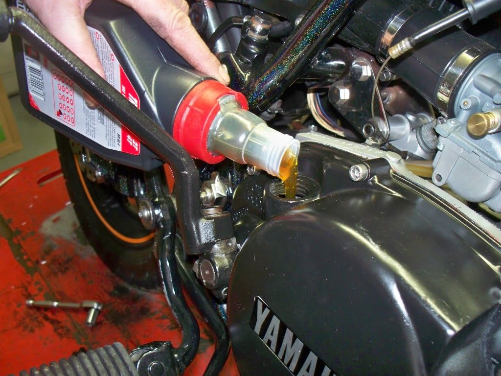

Fill up with gearbox oil.
Thats the botton end done.

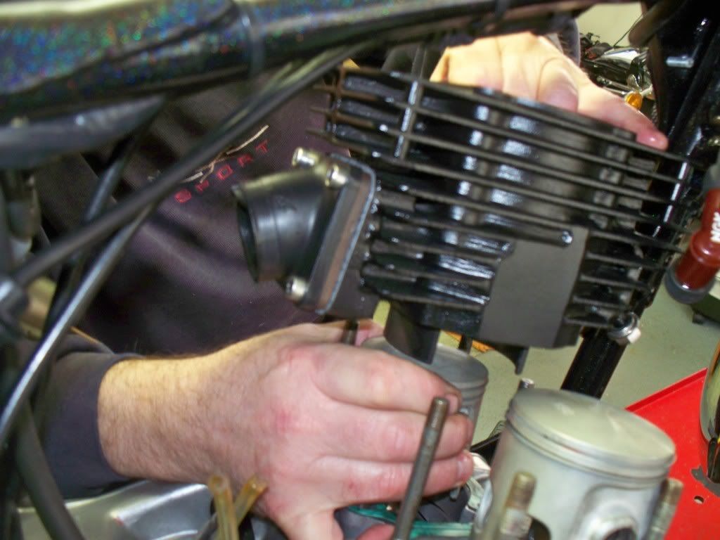

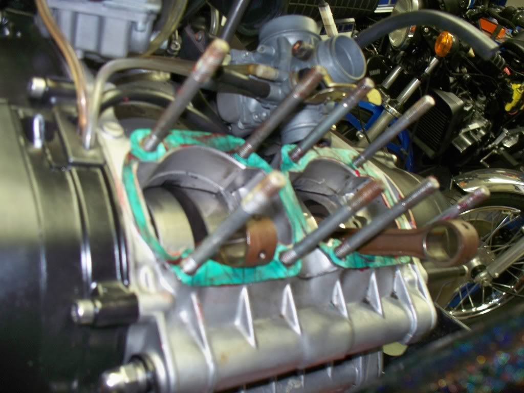

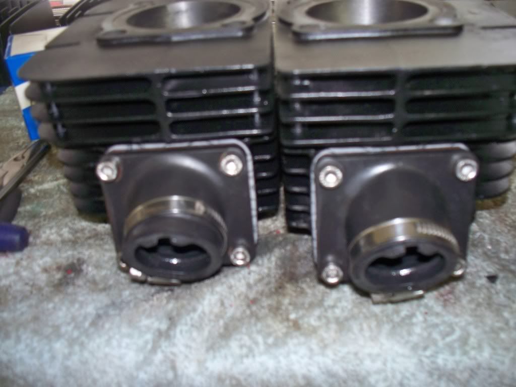

Now Norbo has delivered the barrells and heads so time to sort the top end.

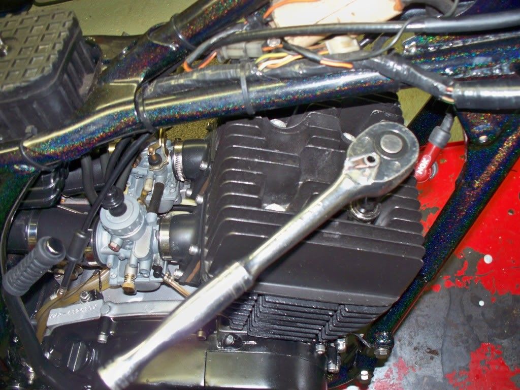

Removed the heads
Then the carbs and barrells
Swop over the reads.
New gaskets used.
Clean up ready to fit the new base gasket

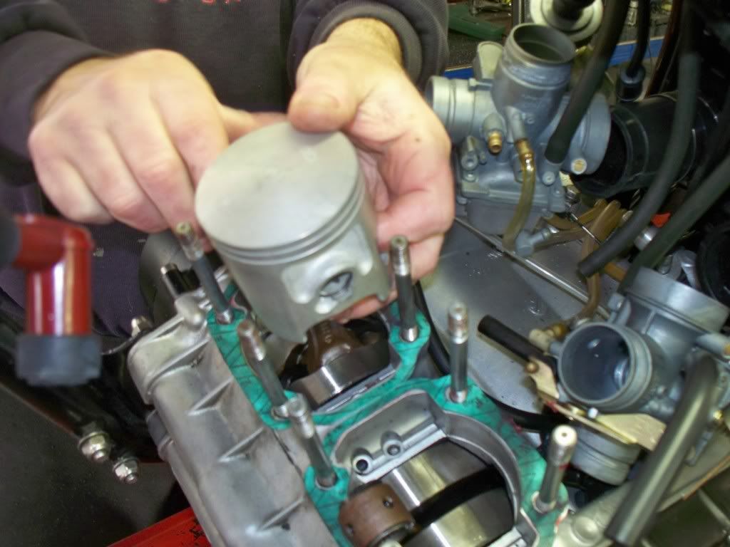

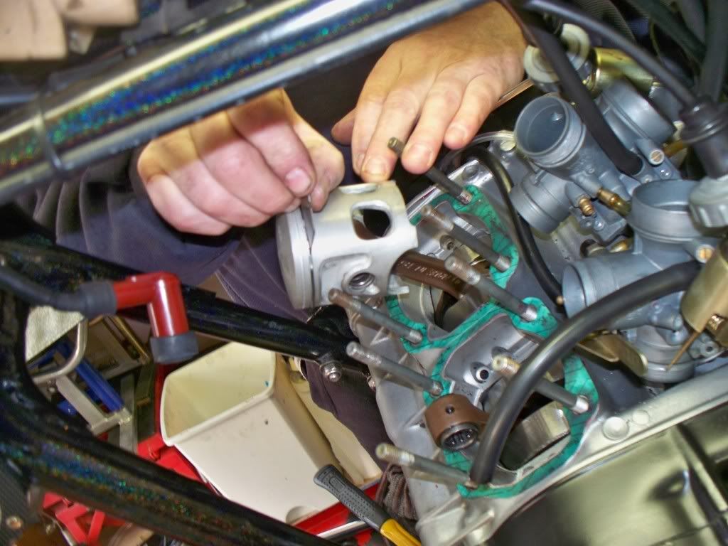

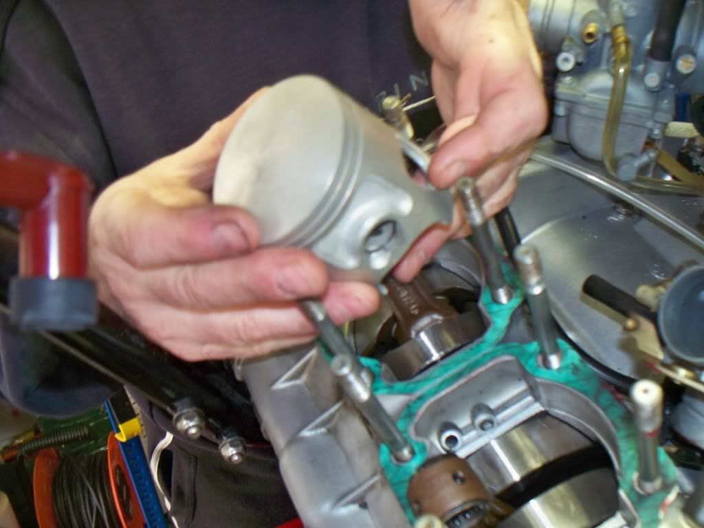

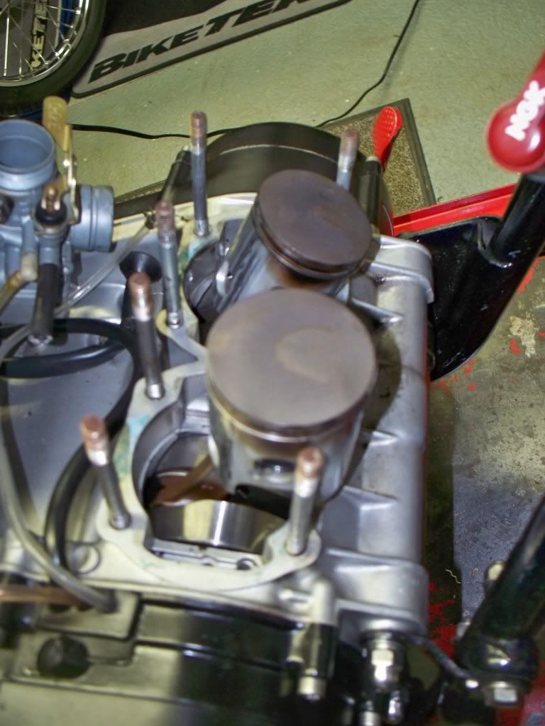

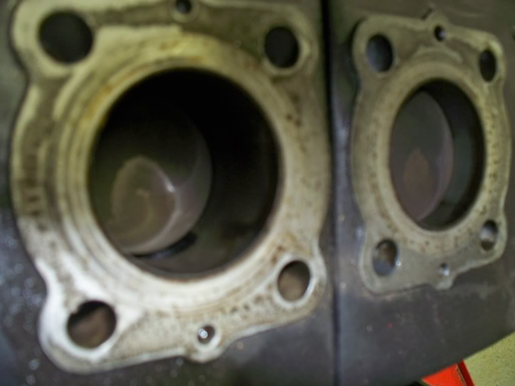

Remove the old 250 pistons.

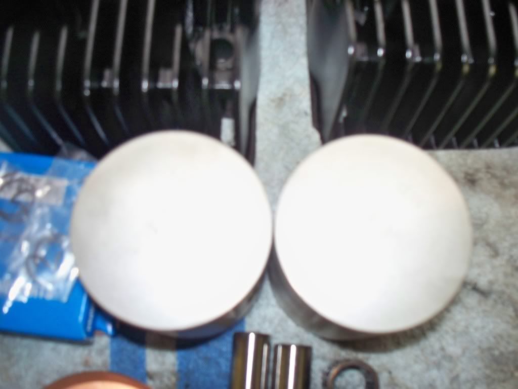

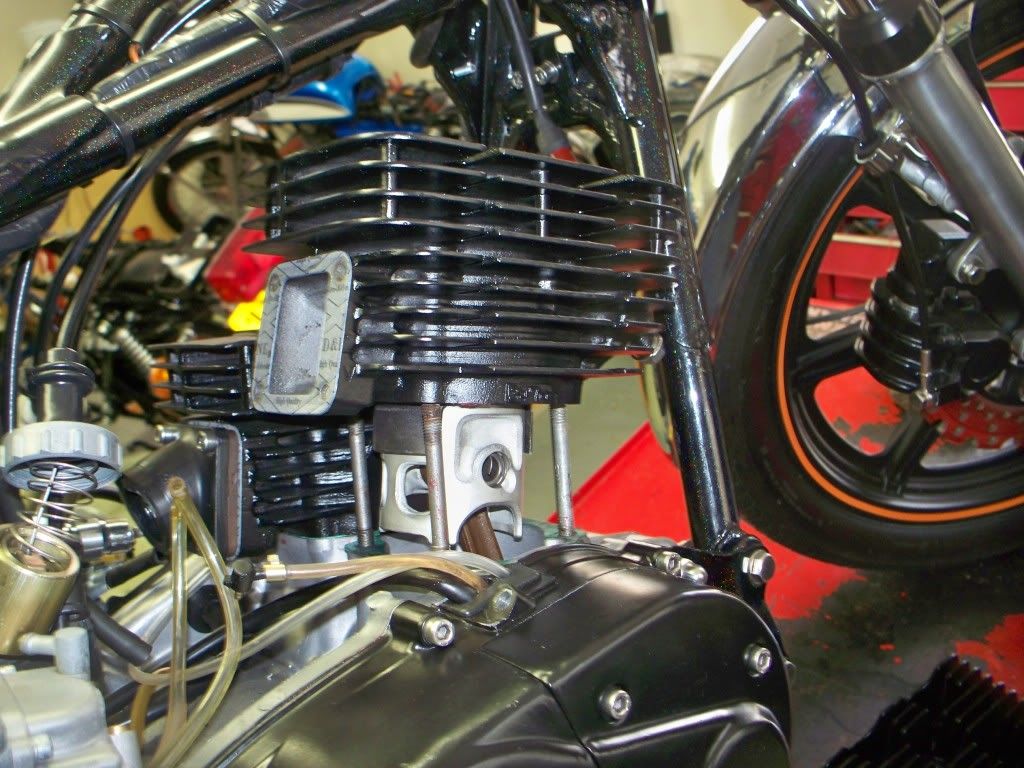

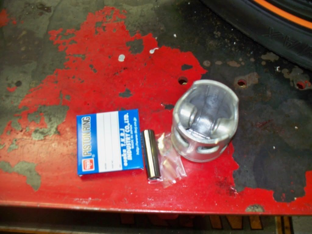

Heres the new 350cc pistons ready to go in
Time for a tea break now.

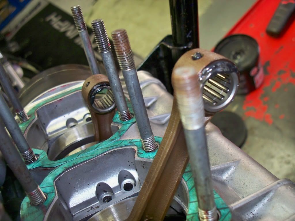

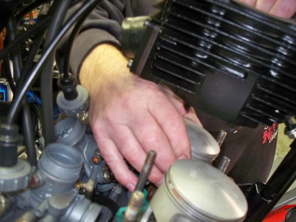

Little end bearings arrived in the post so time to make a start
Fit the rings

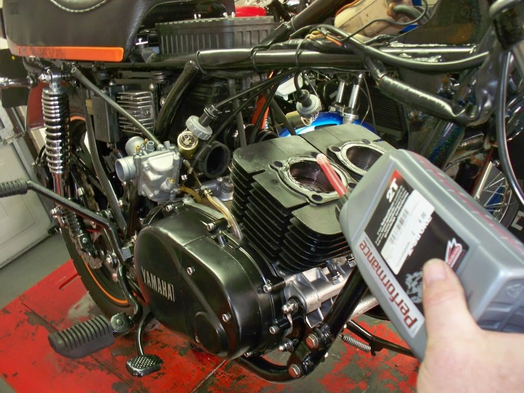

Fit the pistons
Add a bit of two stroke down the barrel.
Refit the oil pump cable and torque down the heads

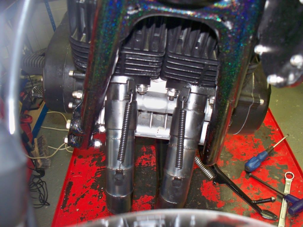

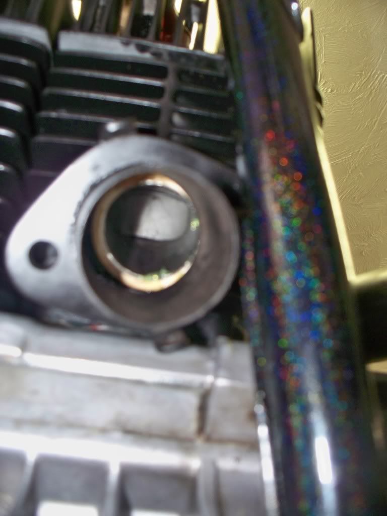

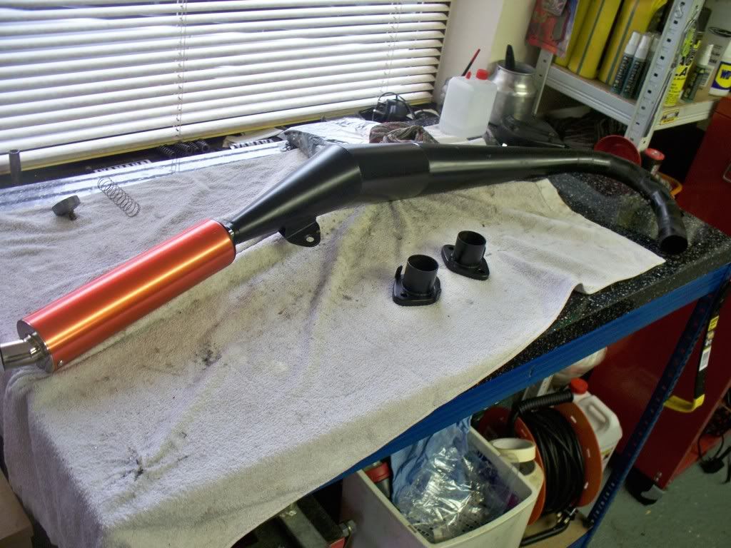

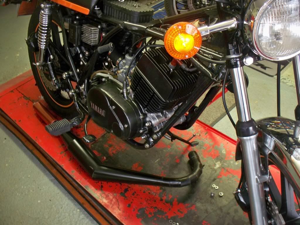

Next job was to fit the exhausts when I found the colleres on the 250E barrels will not fit on the 350 barrells so I have spocken to Martin Newlyn and he is making us a new set so until they arrive I cant do anymore.
These arrived in the post yesterday
So I went out in the garage early Sunday morning to finish her off.

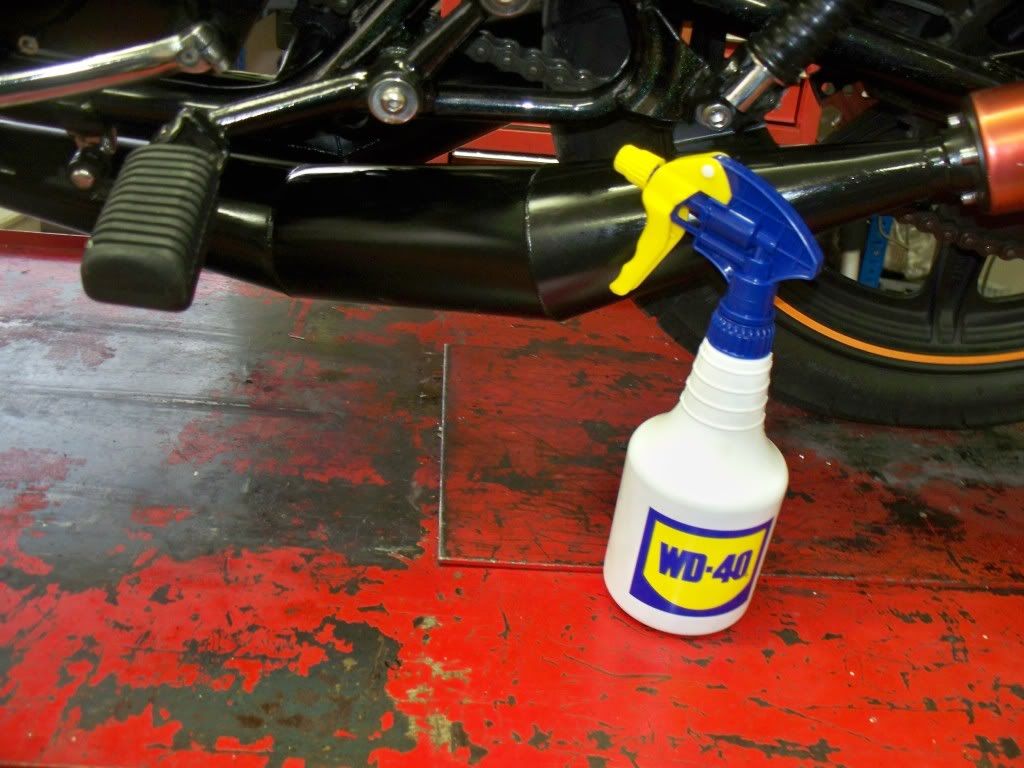

I gave the pipes a good clean with WD40
New gaskets, I greased these so they stayed in place.

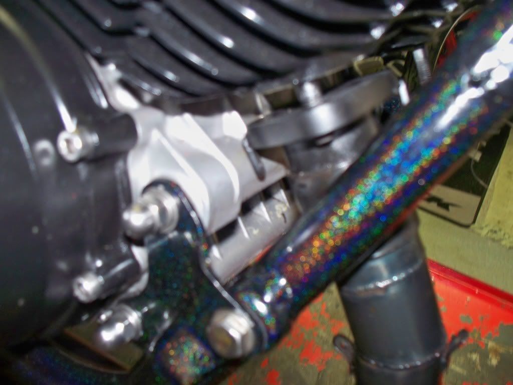

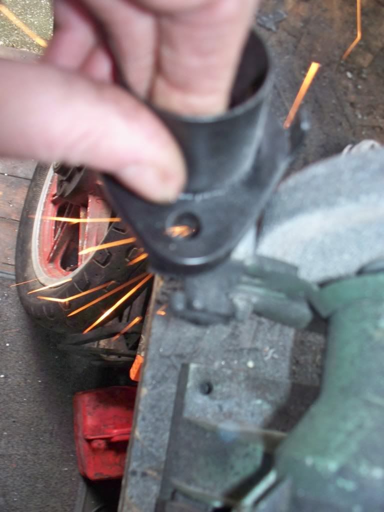

I managed to fit the right hand pipe but the collar is very tight to the engine case but I just went in.

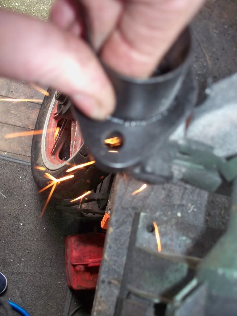

Now for the left hand pipe, not so lucky, the collar is a bit big and hits the engine case, this is because the angle of the new barrels, problem is martin made the collars without having the bike so it was just guess work really.
There was only one thing for it, get the grider out and grind it down a few MM
It fits now
Looking good

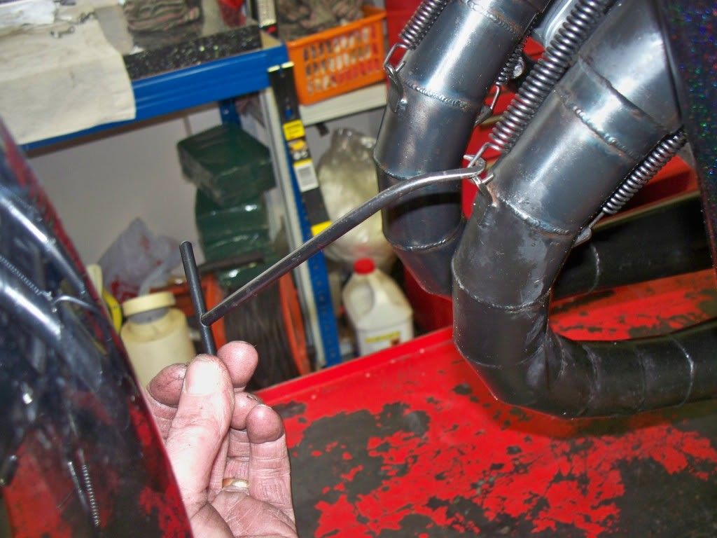

If you have not got one of these spring pullers in your tool box then you really need one.
Its one of my favorite tools.

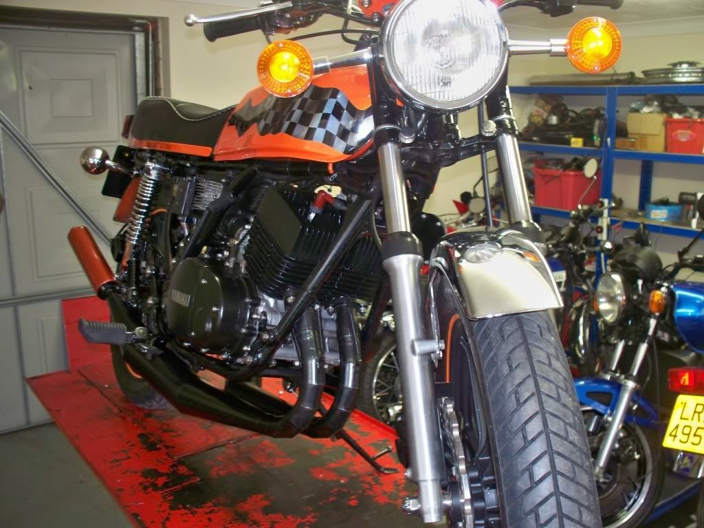

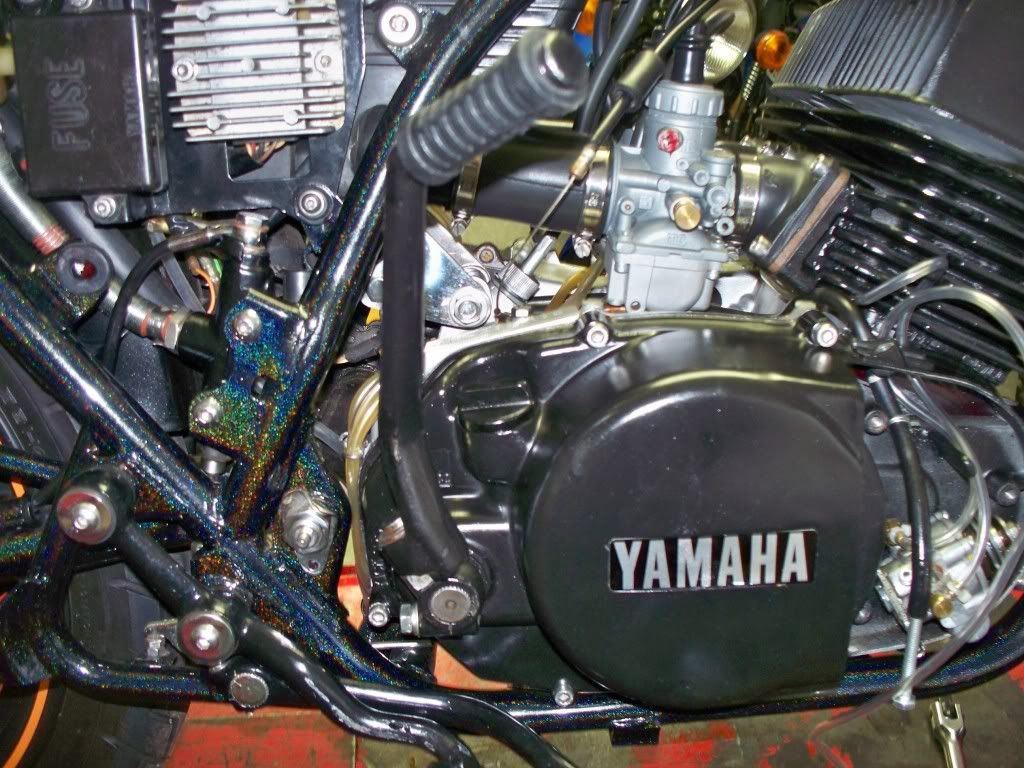

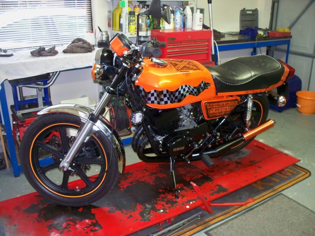

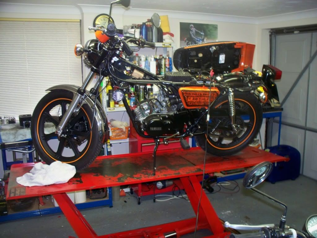

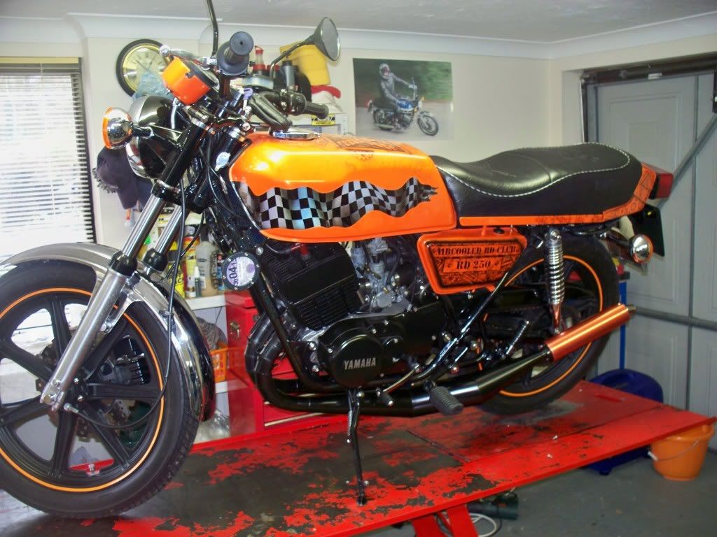

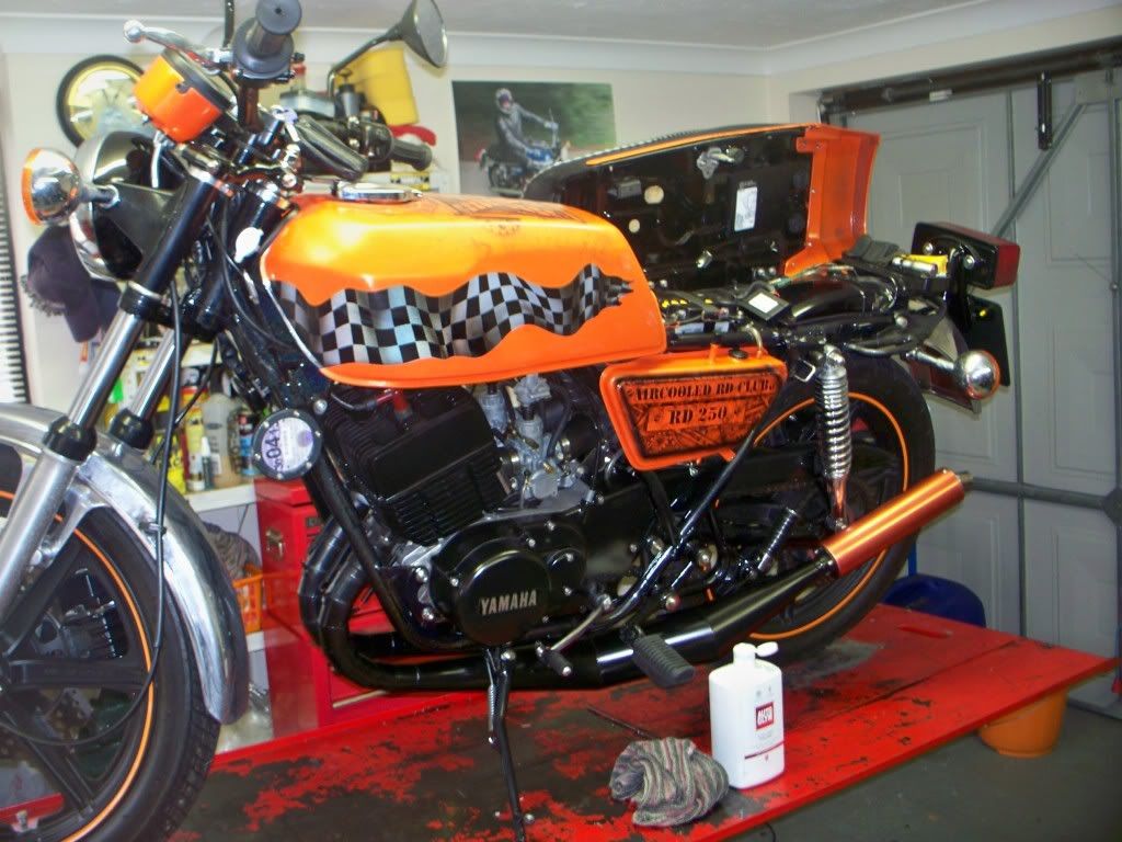

The bike is now finished but she needs a clean.
I wash all the black with WD40
Then polish all the shiney stuff with Autogleam polish.
Project X looks like new now.
