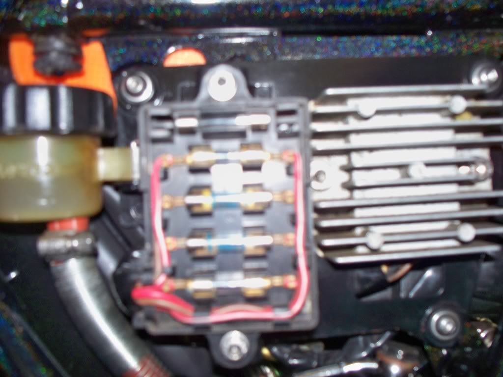

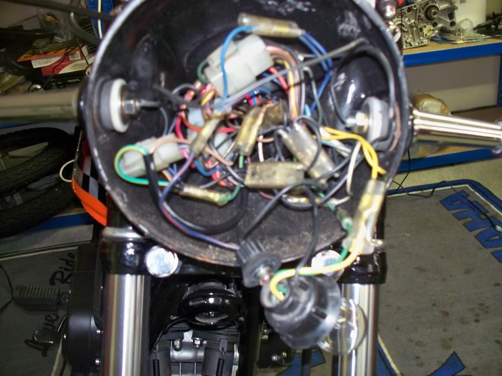

Checked all the fuses and they are fine, checked all connections and all OK.

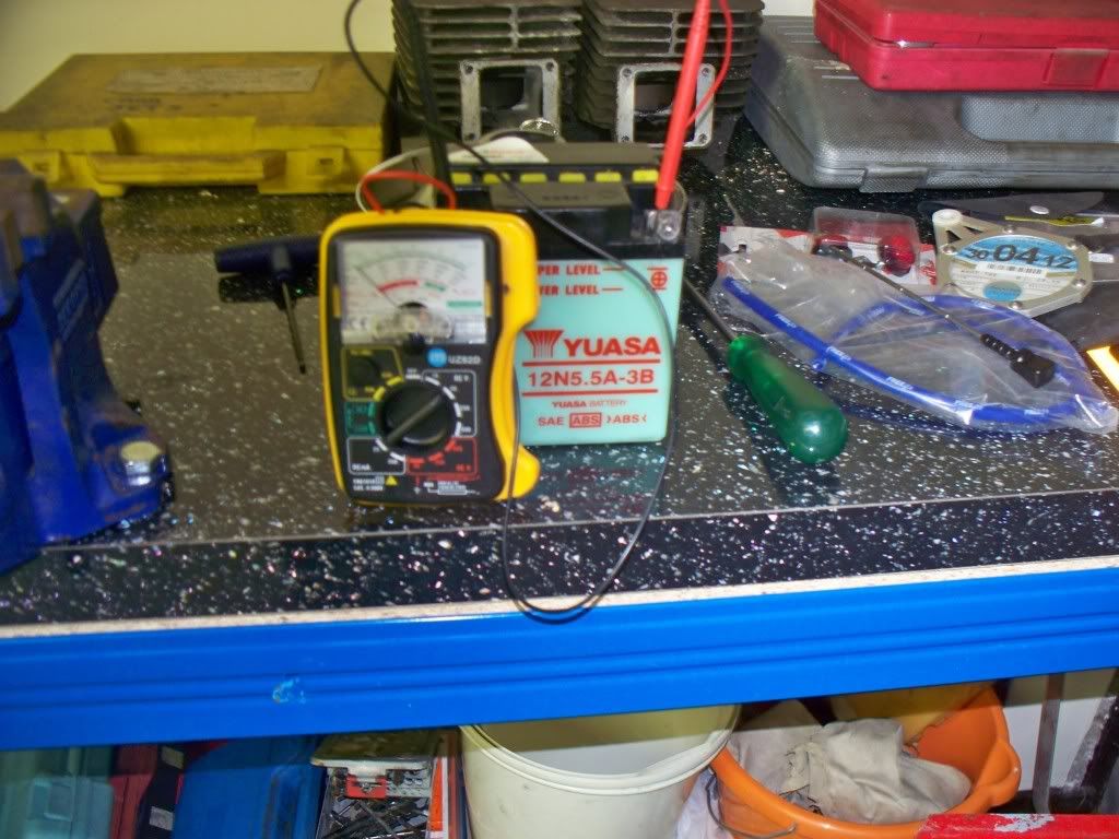

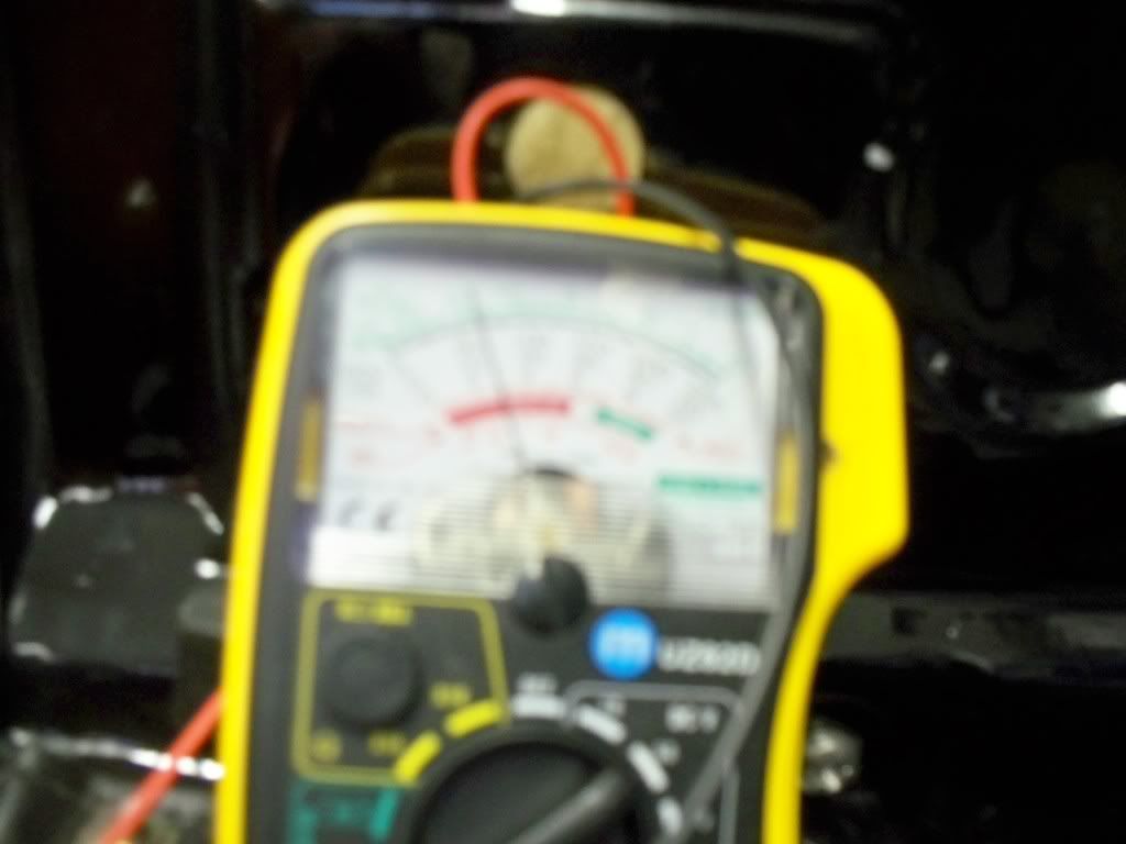

So I thought I would put the meter on the battery.
There was nothing at all, but the battery was charged and OK on the optimiser so I put the meter on my battery fitted to my special.

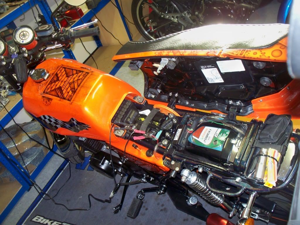

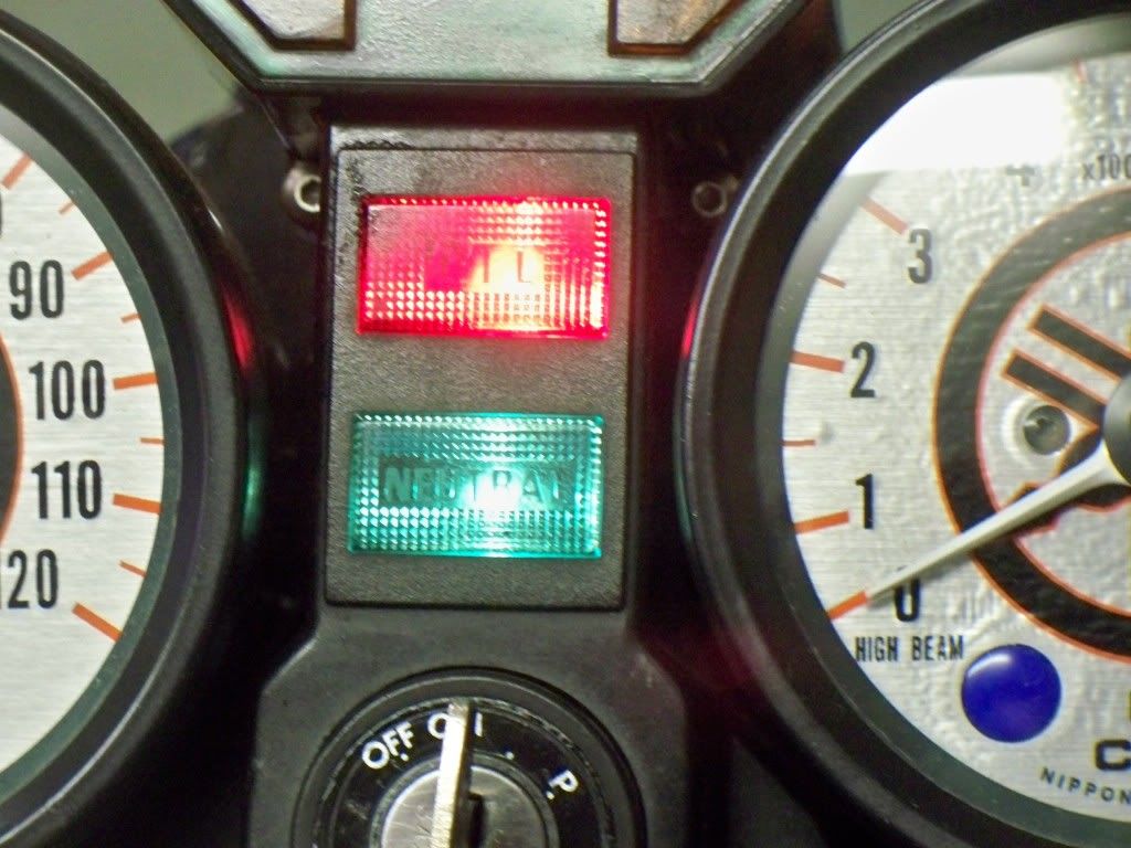

Fitted my battery to Project X and all working, changed a few bulbs and sorted a front indicator and it all apears OK now.
