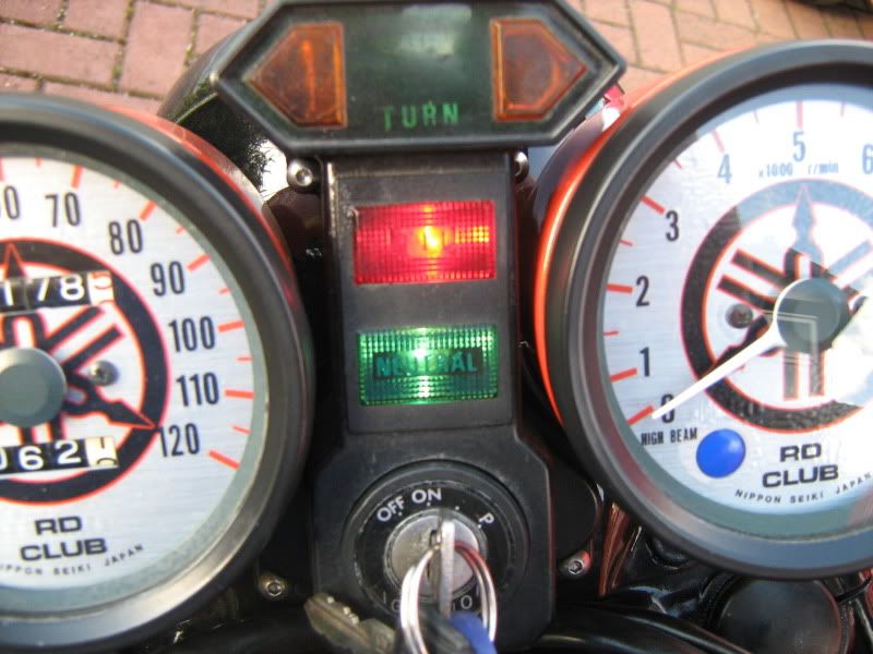

Paul had said the battery was a bit weak, and it came as no suprise when I turned on the Ignition Key last week no lights on the dash

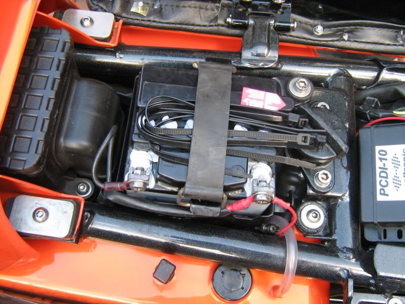

So this morning was over at the bike shop and bought a new battery.
Old battery on its way out

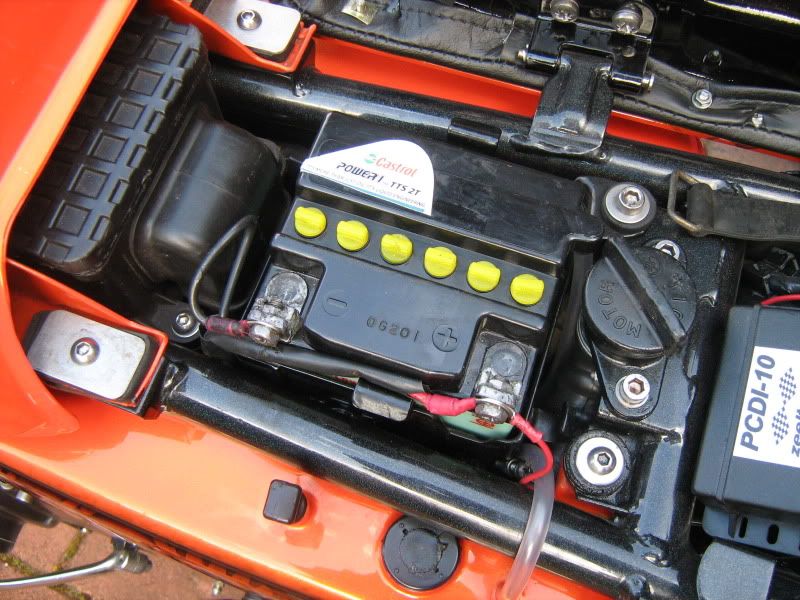

new battery fitted and tie wraps replaced under strap?
Instant Lights on the Dash!

Bit more information.
Put the Yuasa Battery on the daytona and it held a charge. the new exide battery wasnt keeping its charge overnight despite a 50 mile run out.
So I checked and the electronic ignition unit is connected directly to the battery, so is permannetly live, so I guess its a drain when the bike is in use, I know paul used to keep an optimate on the bike pretty regularly so he wont have noticed.
So I"ve refitted the Yuasa battery as it seems a lot better than the Exide one!
