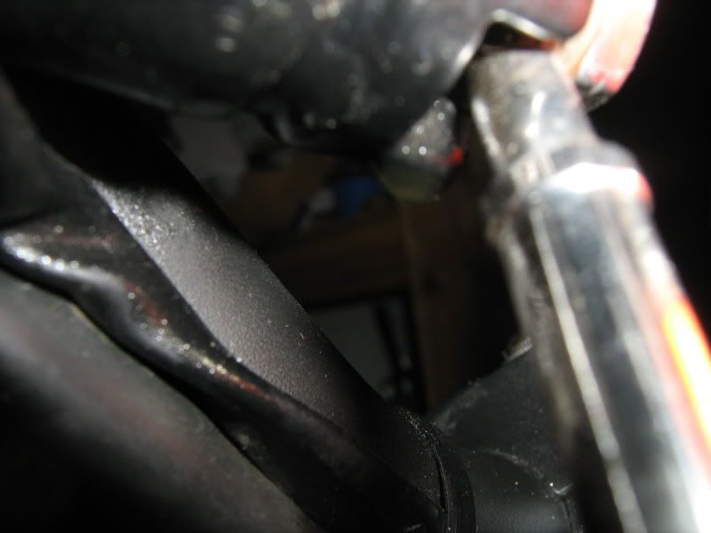

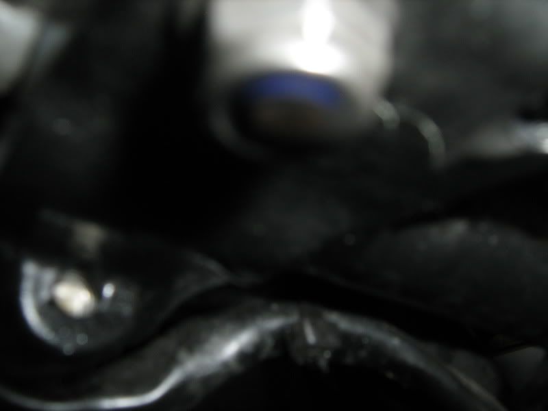

Ok so had a closer look at the underside of the cylider and there an amount of fluid that has leaked from the underside on to the headstock and although its difficult to photograph here are a couple of pics
Its actually very difficult to identify the source but as said I reckon its coming from the joint between the reservoir and the cylinder

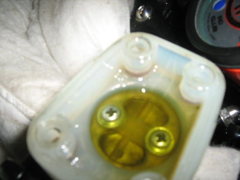

Looking at the pic you can see the fluid level has dropped
this was the level once the diaphragm had been lifted out

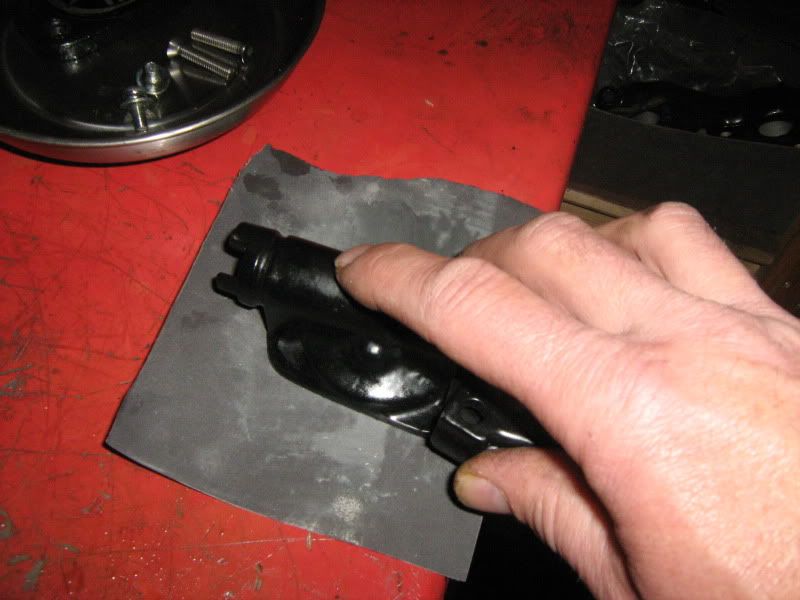

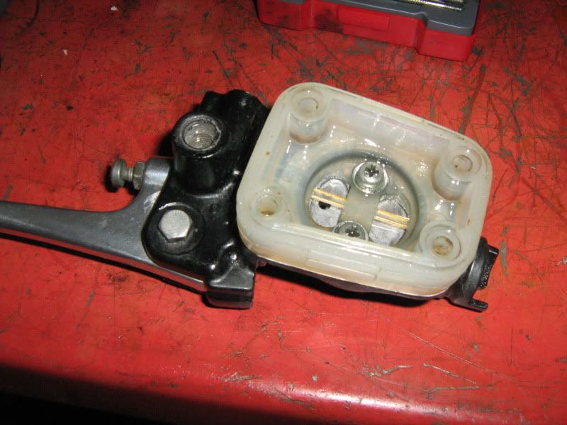

So removed the cylinder from the bike and the reservoir from the cylinder, removed the O ring and gave it and the groove a good clean
Alsso flatted off the mating surface of the cylinder
A bead of silicon around the neck of the reservoir, carefully fitting and watching for excess being expunged from the joint
screws refitted and left to set
The cylinder was refitted to the bike the other night, the bike has been on a run today and I havent noted any re-occurence of the problem
