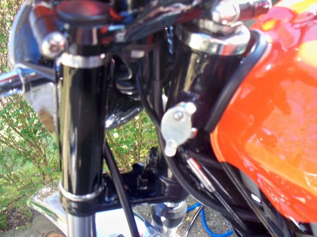

Project X never had one.
When at shows or bike nights its difficult to take a lock and chain so I thought it was best to fit the steering lock.

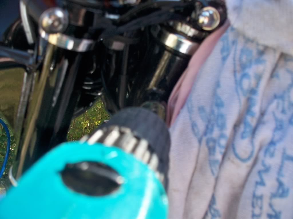

Problem was the pin was snapped of, I tried drilling it but it was very hard but i manged to drill it out about 4mm

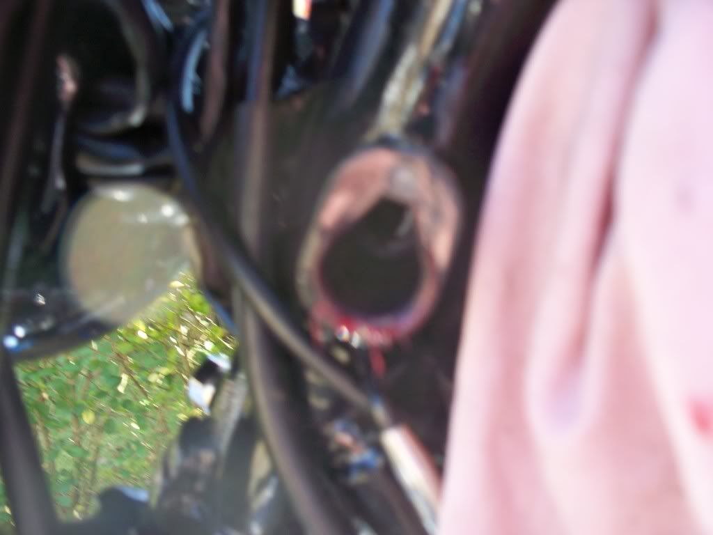

I thing filed out the lock hole to remove all the paint and crud.

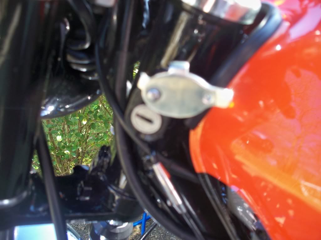

I greased up the spring and the new lock from Yambits.
I had to cut the pin down to fit in the hole as I could only drill it out 4mm and it was 6 mm long
Pushed it in and fitted the cover donated for free from club member COLIN987
